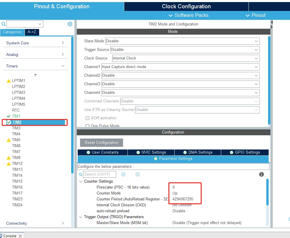

Currently using NUCLEO-STM32H723ZG board.
I'm setting TIMER1 as a PWM output, TIMER2 set as Input Capture direct mode
try to measrue the frequency output from TIMER1.

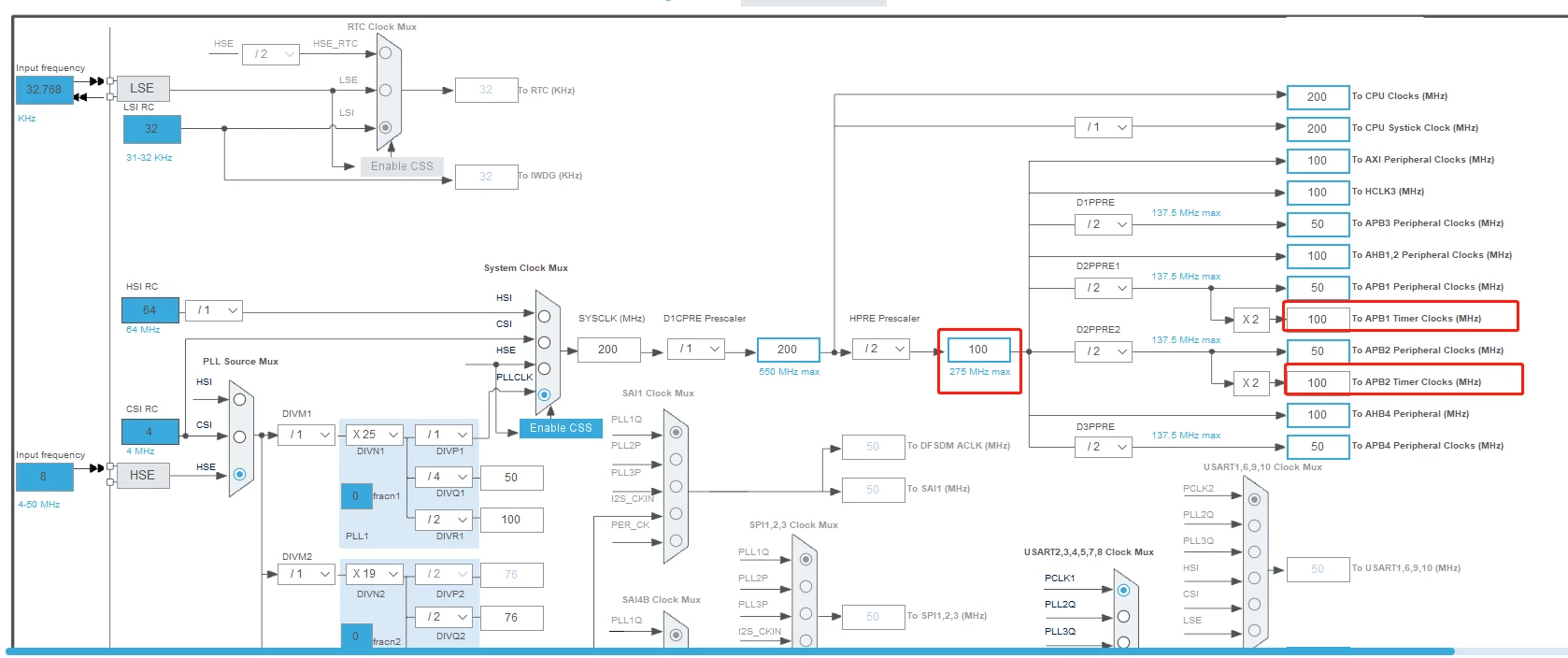

Clock Configuration : APB1/ APB2 Timer Clocks 100 (MHZ)

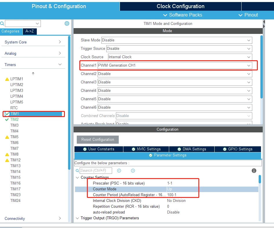

Timer 1 :
  • Prescaler : 1-1
  • Counter Period : 100-1
  • PWM output
Timer 2 :
  • Input Capture direct mode
  • Prescaler : 0
  • Counter Period: 4294967295
_legacyfs_online_stmicro_images_0693W00000bjeLdQAI.pngWhenever I modify the TIMER1 output PWM over 200KHZ, I can't get the stable value or even zero from the ​HAL_TIM_ReadCapturedValue.
I set the TIMER1
  • prescaler : 2-1
  • Which will generate the PWM to 100M / 2 / 100 = 500MHZ.

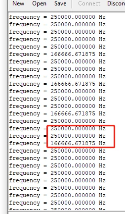

But I got read back like this.
Idealy TIMER2 run under 100MHZ( APB/PSC) should be able to capture up to 10MHZ signal.
eventually I need to measure a signal up to 100MHZ, If i set the APB bus to Max frequency (137MHZ) will this method works? or is there any other way to measure it?
Hardly so. With Cube/HAL, and optimizations switched off, hundreds of cycles per interrupt are the norm.
Even using DMA it would be a challenge to measure 1/10 of timer clock reliably by using captures.
Try timing a number of input clocks using external clock mode and a second timer as a time base.

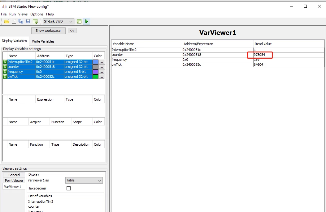

I have followed your suggestion and set up two timers to measure. and remove all the printf() in the related path. For this require only need to measure the frequency about 1M~100MHZ.
Currently, I am using TIMER1 to generate a 10KHZ PWM waveform and directly inputting it to TIM2 for measurement. I set TIM5 to trigger an interrupt after 1 second has passed to calculate the frequency.
This is the current setup for configuration.
Main CLK : 550MHZ , APB1/APB2 : 275MHZ
TIM1 : Internal Clock, PWM Generation CH1, PSC 275-1, Counter Period 100-1. ( Which will generate 10KHZ PWM output)
TIM2 : ETR Mode, PSC 275-1, Counter Period 65535. ( which mean I'm sampling in 1MHZ , and every time get 65535 count will into Interrupt)
TIM5 : Internal Clock, PSC 275-1, Counter Period 1000000-1. ( Which will into Interrupt every 1second)
However, every time I add the interrupt function for TIM5, it causes an error in my output. The value of __HAL_TIM_GET_COUNTER(&htim2) should always be less than 65535, as I have set it, but it always exceeds this limit. As you can see from the counter value below, it is over 65535.
I am not sure which part of my settings is incorrect.
