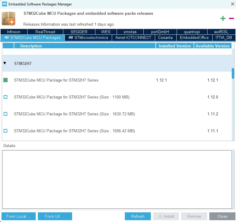

 Hello, @STackPointer64 @Pavel A.
I went through the LwIP_UDP_Echo_Server code.
      From the code you provide I face this problem:
      I can be able to ping it when I flash it once and if I rebuild the project and flash it once again
it goes into hard fault error. I don't know why?
      I double checked the Ip address and no fault in that
      I checked it with another PC after the one-time flash and that is also not pinging.
     If I disconnect and connect the power to the board and that time also, I can't be able to ping.
     Below is the package which I'm using.
