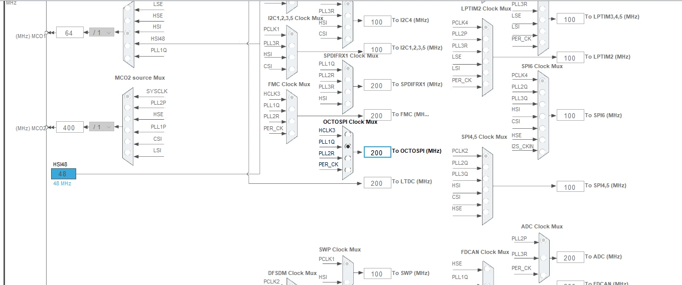

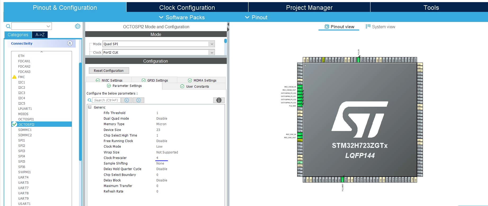

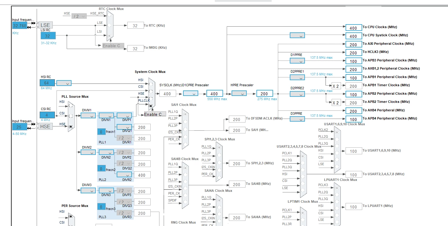

STM32H723 wrong data when interfacing QuadSPI & OctoSPI RAM
Starting from a working application based on the STM32U585A microcontroller, we changed the CPU to have the ETHERNET peripheral available. The flash is connected via quadSPI to the microcontroller, while the RAM is connected via octospi .
Microcontroller Model: STM32H723ZGT6 FLASH MODEL: S25FL064L DRAM MODEL: APS6408L
Regarding the configuration operations of both the flash and the RAM, everything seems to work, but when it comes to reading or writing, we receive incorrect data once out of 10 attempts. Note that we have a working application with the STM32U5 microcontroller using the same flash and RAM.
Any idea on what I’m I missing?

Did you set the same clock config for OCTOSPI as U5 ?
In order to give better visibility on the answered topics, please click on 'Best answer' on the reply which solved your issue or answered your question. Saket_Om
franckngatcha
Jul 7, 2025 9:18 AM UTC
Hi sacket_Om,
we'd configure the flash and the ram to run at 50MHZ
i've tried to reduce that speed without result.
Franck

Hello @franckngatcha
Please try to use the same OCTOSPI initialization setting as in U5 examples.
franckngatcha
Jul 8, 2025 6:42 AM UTC
hi SACKET_OM ,
 i share with you the two examples i'd made, one for the SRAM and the other one for the QUADSPI flash? i already have a working application on the U5 microcontroller with both the flash and the SRAM and we've move the application to the STM32H723 microcontroller.  the only difference is on the use of SDR instead of DTR communication on the QUADSPI FLASH.
