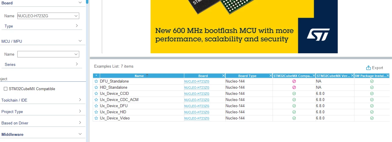

I was trying to use the usb cdc acm example from STM32CubeMx for a Nucleo-H723ZG board. When i run the example, the device doesn't get detected at by my computer.

I noticed in the main.c that only dma and gpio init are called but nothing for the usb.

The USB is initialized when MX_ThreadX_Init is called.
Hopefully you're using the USB connector at the bottom edge of the board. Make sure you have a good USB cable with data signals and not a charging cable only cable.

I only see tx_kernel_enter() in Mx_ThreadX_Init. Do i have to add the USB code myself for the example?

Nucleo-H723ZG examples do not include CDC.
https://github.com/STMicroelectronics/STM32CubeH7/tree/master/Projects/NUCLEO-H723ZG/Applications/USB_Device
Probably you're using some other source, and we don't know which.

I was using the stm32cubemx and the cdc example is there

No, you can see the USB files/folders that were added. With some referencing, starting with usb_otg.c, you can work backwards starting with MX_USB_OTG_HS_HCD_Init and see what function calls it, then the function before that and so on until MX_ThreadX_Init
