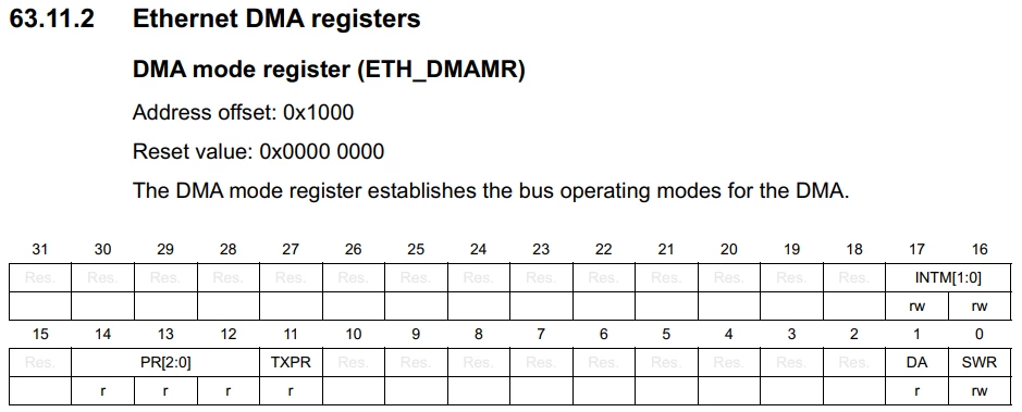

Hello!
I got a new STM32 Nucleo-H723ZG, now i am testing about many days, but i have a big Problem, is use the new Stm32CubeIDE 1.5.2 with actually Firmware for the MCU.
The Problem is, i loaded a new Cube Project with Default Values, for the Board without any Changes, now when i run or debug my project, hangs my MCU on this Code:
HAL_ETH_Init:
 /* Ethernet Software reset */
 /* Set the SWR bit: resets all MAC subsystem internal registers and logic */
 /* After reset all the registers holds their respective reset values */
 SET_BIT(heth->Instance->DMAMR, ETH_DMAMR_SWR);
 /* Get tick */
 tickstart = HAL_GetTick();
 /* Wait for software reset */
 while (READ_BIT(heth->Instance->DMAMR, ETH_DMAMR_SWR) > 0U)
 if(((HAL_GetTick() - tickstart ) > ETH_SWRESET_TIMEOUT))
 /* Set Error Code */
 heth->ErrorCode = HAL_ETH_ERROR_TIMEOUT;
 /* Set State as Error */
 heth->gState = HAL_ETH_STATE_ERROR;
 /* Return Error */
 return HAL_ERROR;
i got an HAL_ERROR, and the MCU Goes to from the Main Function to the Error_Handler...

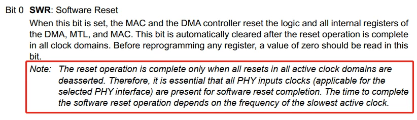

HJing.2
Visitor II
Jan 6, 2023 6:13 AM UTC
