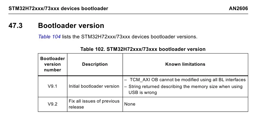

 I use STM32H723VET6. Bootloader ver 9.2. When I can send command GO at FDCAN (PD1, PD0), I receive ACK(0x79), but after that MCU is fail.

Write memory and Erase memory commands run correct. A program in flash memory mode (BOOT0 pin LOW) run correct. There are no limitations in AN2606:

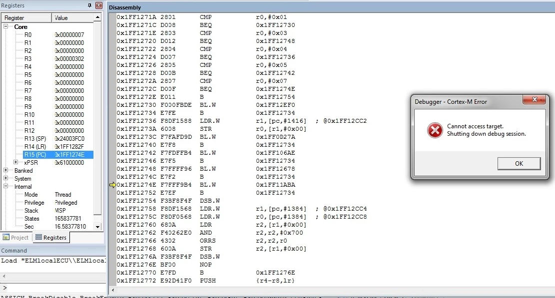

0693W00000FAPgWQAX.jpgI tried to run the debugger on the STM32H723 (device side). I stop the program, and after the command GO I start it again in step mode. After of several steps disconnection occurs:

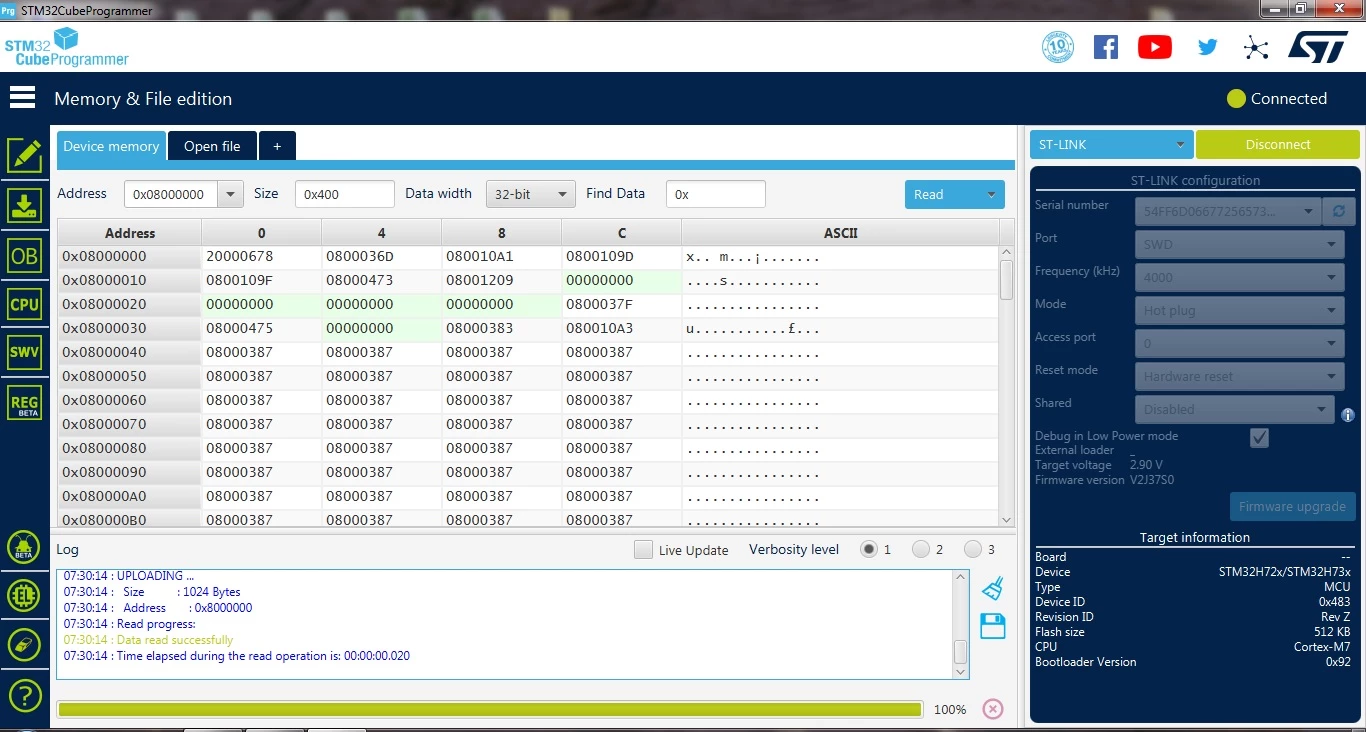

0693W00000FAQMNQA5.jpgFlash in STM32H723:

The address of the entry to the main() does not appear in the PC register. Failure occurs in system memory. I checked the VTOR register through CubeProgrammer (0xE000ED08), turned on disable interrupts in main program, nothing helped.

Above in the line of the disambler:
-> 0x1FF1274E F7FFF9B4 BL.W 0x1FF11ABA
there is a write the address of the next instruction to LR: 0x1FF1ABA, which does not exist.

After reset:
0x1FF11AB2 E8BD4070 POP {r4-r6,lr}
0x1FF11AB6 F7FFBD38 B.W 0x1FF1152A
0x1FF11ABA E92D4FF8 PUSH {r3-r11,lr}
0x1FF11ABE 2000 MOVS r0,#0x00
0x1FF11AC0 F8DF446C LDR.W r4,[pc,#1132] ; @0x1FF11F30
During the execution of the program, I have the following register values:
0x1FF11AB1 BD46 POP {r1-r2,r6,pc}
0x1FF11AB3 70E8 STRB r0,[r5,#0x03]
0x1FF11AB5 FF4038F7 DCD 0x38F7FF40
0x1FF11AB9 2DBD CMP r5,#0xBD
0x1FF11ABB F8E9004F STR r0,[r9,#0x4F]
0x1FF11ABF DF20 SVC 0x20
0x1FF11AC1 6CF8 LDR r0,[r7,#0x4C]
0x1FF12748 F7FFFF96 BL.W 0x1FF12678
0x1FF1274C E7F2 B 0x1FF12734
0x1FF12752 E7EF B 0x1FF12734
