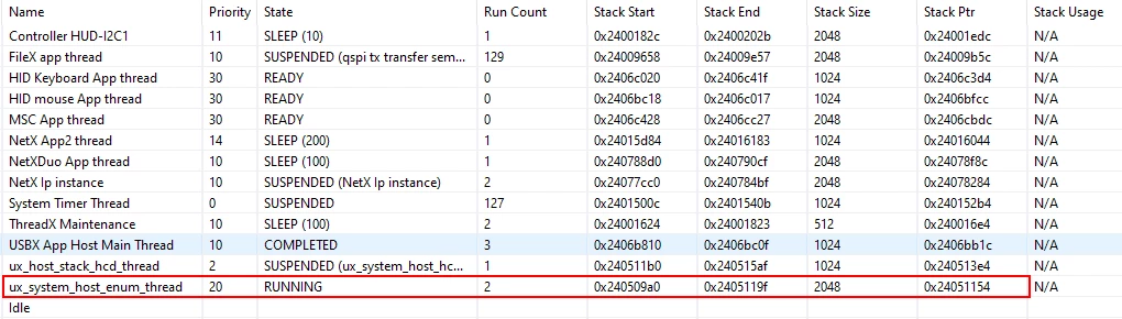

UX_HOST_ENUM_THREAD_STACK_SIZE  (2 * 1024)
UX_THREAD_PRIORITY_ENUM  20
yes, _ux_system_host -> ux_system_host_enum_thread_stack is properly allocated
it  is not allocated in .bss, it is using threadx pools, and the demo put it here:
#if USE_USBX_HOST == 1
__attribute__((section(".UsbxPoolSection")))
__ALIGN_BEGIN static UCHAR ux_host_byte_pool_buffer[UX_HOST_APP_MEM_POOL_SIZE] __ALIGN_END;
static TX_BYTE_POOL ux_host_app_byte_pool;
#endif
 /* Used for USB OTG */
 .UXApp_region 0x24035000 (NOLOAD):
 *(.UsbHhcdSection)
 } >RAM_D1
 .UXApp_region_pool 0x24036000 (NOLOAD):
 *(.UsbxAppSection)
 } >RAM_D1
 .UXApp_region_pool_app 0x24050000 (NOLOAD):
 *(.UsbxPoolSection)
 } >RAM_D1
the ux pool is 128K (your demo was at 120K). from 0x24050000 - 0x2406ffff

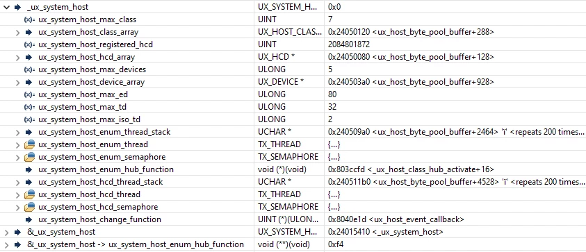

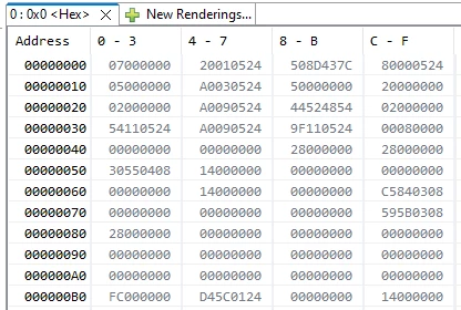

One of the problems is the main structure (pointer) _ux_system_host is not initialized.  The address for _ux_system_host is 0x00000, so it is storing the values of the structure in the ITCMRAM section and it is not using the pool like all the other variables.  I don't know if this is where you intended to keep the structure, but I had to turn off the icache so it didnt over run the structure.
Also, the _ux_system_host_enum_hub_function is not set properly... it should be ux_host_class_hub_activate, but for some reason there is a +16 added to the function, so when it tries to jump to the hub function, it gives an address error.

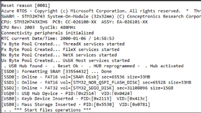

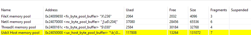

@FBL
semaphores seem to be setup properly:
memory pools look ok.  They are where I expect them to be,
