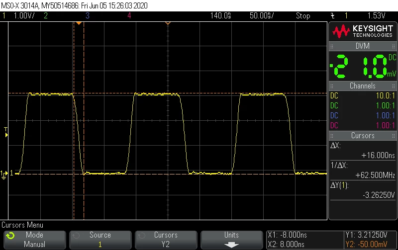

I'd also suspect that this is may be a consequence of excessive raw data error rate (which may be hidden by hardware and other parts of the stack), so you may want to look at the DP/DM signals' integrity, too.
What stick is this, exactly?

The signals are ok I would say. The lines between STM and USB Jack have the same length (designed with AD19), they are 90 Ohms impedance, the total length is a bit more that 2cm. The signals (DP and DM) look at any point along the line like this:
BTW it's officially upgraded to 3024 200MHz BW.

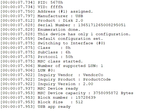

Yes it's quite reproducible. The first few sectors (3 to 10 something) can be read, then the toggle error occurs. MIght be some clock drift problem? My Agilent scope can trigger SOP, EOP full speed/low speed, that's it. There is no protocol analyzing feature for USB. Any suggestions for an USB analyzer? I only need FS.
waclawek.jan
June 5, 2020
I use a cheap LA, Asix Sigma2 with USB plugin, not the greatest but workable. I am by no means an USB expert and try to avoid it as much as possible.
I have heard praise on the Beagle USB analyzer.
Signals look good. PID 0x5678 and VID 0xffff, that tells a lot. Unfortunately, it's hard to explain to the customer.
Even with tools, this is no joy. I personally would try the widest selection of flash disks as you can get hands on (including whatever family and friends can offer), and if this turns out to be specific to this one particular disk, I would try to talk to the customer.
