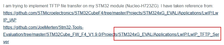

I am trying to implement TFTP file transfer on my STM32 module (Nucleo-H723ZG). I have taken reference from:
https://github.com/STMicroelectronics/STM32CubeF4/tree/master/Projects/STM324xG_EVAL/Applications/LwIP/LwIP_IAP
https://github.com/JoeMerten/Stm32-Tools-Evaluation/tree/master/STM32Cube_FW_F4_V1.9.0/Projects/STM324xG_EVAL/Applications/LwIP/LwIP_TFTP_Server
For file transfer I am using tftpd64 software. I used the software for PC-PC file transfer which were on the same local network and it was successful. But when I am trying to send file from PC-STM32 module I am only receiving write request from the client (PC). After that  I am suppose the get a block 0 acknowledgement from the server (STM32 module) which I am not receiving.

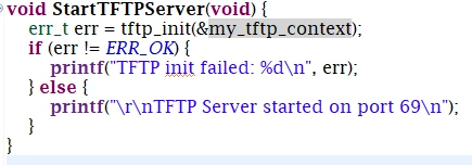

For TFTP server to work properly it is recommended to use the tftp_server source and header files in Middleware. Earlier I was referring to the GitHub code in which a different file is created for initializing TFTP server, which came with many problems like mentioned above. After creating new project and by using this autogenerated files by STM32CubeIDE, I accomplished creating a TFTP server on stm module and transfer a file.
Some points to consider when using this file:
- To initialize TFTP server we have to define the function pointers for handling file I/O operations. This structure is used by the TFTP server to manage file transfers, including opening, writing, and closing files.
- This functions are called from the recv function in the tftp_server.c file.

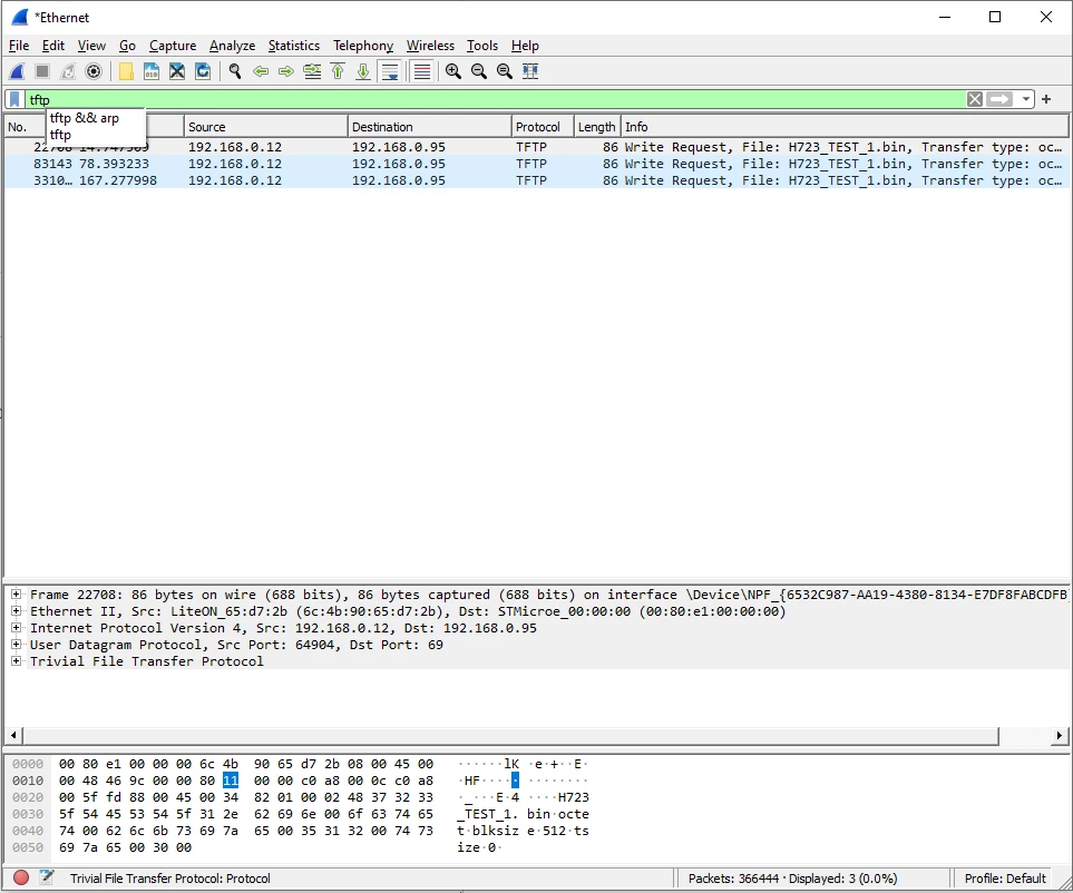

Please do a wireshark capture.
Senior
Apr 1, 2025 6:03 AM UTC
I did the wireshark capture and in that only the write request packet sent by the client is displayed.
But while debugging the code the ack is being sent successfully without generating any error. I checked the ip address and the port that it is sending the ack. and both the things are correct.

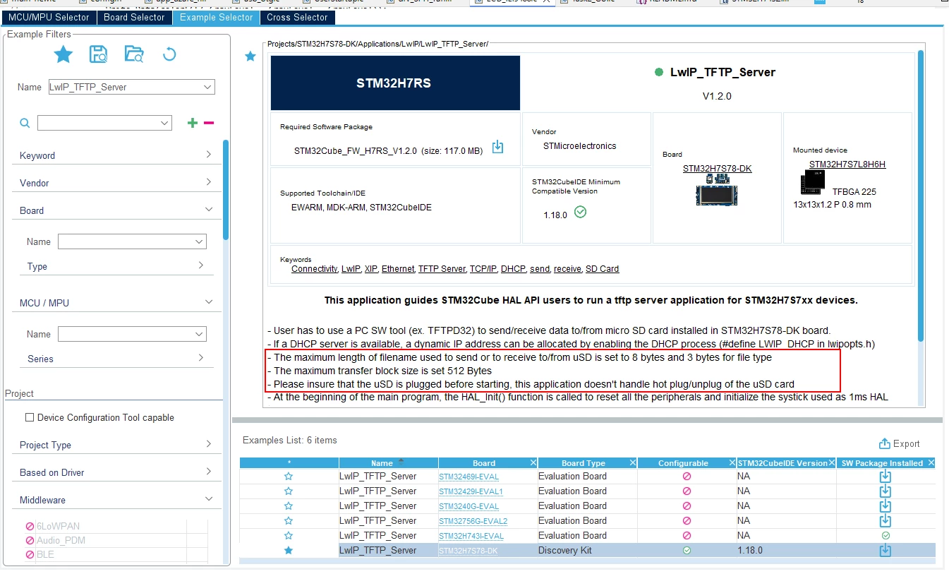

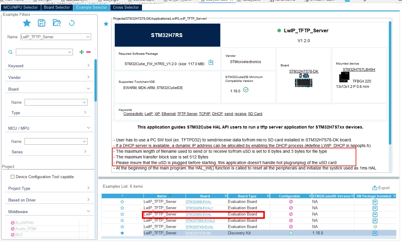

the app note for your project says:
I would fix your filename first... Your filename in your shark capture is invalid.... meaning no response

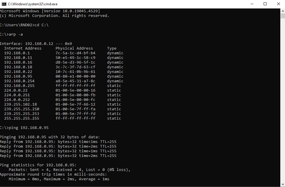

So it appears that the ACK is not sent on the wire. When you capture from the board reset or power on, are ARPs  and ping replies from the board visible?
Senior
Apr 1, 2025 10:55 AM UTC
Yes the ip address is listed and successfully responds when ping.
matt-crc
Senior III
Apr 1, 2025 10:59 AM UTC
its in the readme, or you can read it when selecting the example from cubemx
Senior
Apr 1, 2025 11:14 AM UTC
No, moreover I am not using a example code from cubemx.
matt-crc
Senior III
Apr 1, 2025 11:19 AM UTC
I assume you are using CubeIDE?
1- File -> New -> STM32 Project
2- On the Top, select "Example Selector"
3- in the search box, type "Tftp", a list of all example project appears on the bottom right
4- Select the row with your processor / demo board
5- Read...

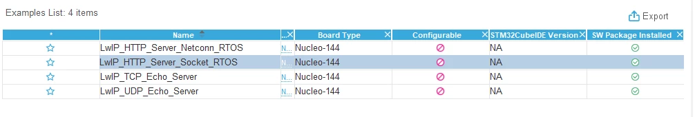

Senior
Apr 1, 2025 11:29 AM UTC
I am using Nucleo-H723ZG which is not listed under the module which has LwIP_TFTP_Server.  The module I am using only has four example codes related to LwIP and none includes TFTP.
matt-crc
Senior III
Apr 1, 2025 11:37 AM UTC
lol.....
you said:
i gave you instructions how to download the project, you clearly didn't read it properly....
anyway... this is becoming a waste of my time.... lol

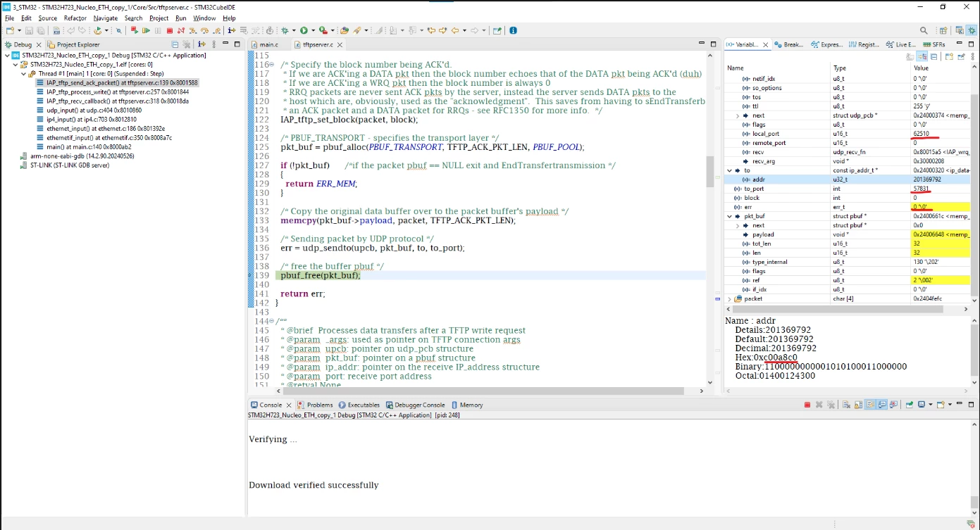

Senior
Apr 1, 2025 12:00 PM UTC
My concern lies here. While debugging we can see that the local port, destination port, addr is correct and after executing the udp_sendto line I got err = 0 indicating that the acknowledgement so successfully sent. But it can be seen in wireshark nor the client proceeds to send the data packets.
