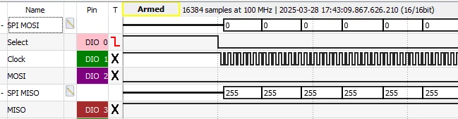

I want to transfer a buffer and receive a buffer of data using a full duplex SPI port with DMA on a STM32H7S3L8H (on the NUCLEO-H7S3L8). My problem is I am not able to modify the transfer buffer and have the modified version sent. I only need to modify the 1st two bytes. Here's the code:

Here is the resulting SPI activity:
Based on the reg_addr being passed the first two values should of been 0x80, 0x18.
Setting a breakpoint on line 14 and looking at the gTxDmaData[] array the first two values have been changed to  0x80, 0x18. However, the original array values of 0x0, 0x0 are what end up being sent.
I have initialized the gTxDmaData array with a pattern and verified that the original pattern is being sent and that the first two bytes are not changed by my code.
If I initialize the first two bytes to 0x80, 0x18 I get a valid response from my SPI slave, however the first two bytes of the response data buffer have not been changed from the original array but the rest of the response matches.

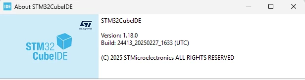

I am using:

Is data cache enabled? Try disabling it. Could also make gTxDmaData volatile.

Mar 29, 2025 2:39 AM UTC
Disabling the data cache fixed the issue.
I started with gTxDmaData as a volatile global and ended up with it just local to try to find a fix. I will be setting it back to a global volatile.
I will also be setting up a dedicated memory block for these data buffers (64KB) and I will make sure data cache is disabled.

You can keep cache enabled if you align it properly and clean/invalidate at appropriate times. Sure is simpler to just disable it if you don't need the speed, though. Or disable it on only a portion of memory using MPU settings.
