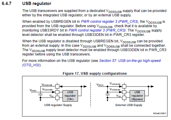

I had the same problem, this function solved it :
HAL_PWREx_EnableUSBVoltageDetector() .
Please add this function call to usb_device.c file like this.

ST team is aware about the issue ofmissing call to HAL_PWREx_EnableUSBVoltageDetector( ) and should fix this limitation in the coming release, but all
depends on releases planning and expected fixes or new features to embed.

I was using this function because the usb voltage on stm32h7 comes from VDD33 voltage level detector.
So the code is actually:
void HAL_PWREx_EnableUSBVoltageDetector(void)
  /* Enable the USB voltage detector */
  SET_BIT(PWR->CR3, PWR_CR3_USB33DEN);
Is stm32f767 has a USB regulator that needs to be enabled?
