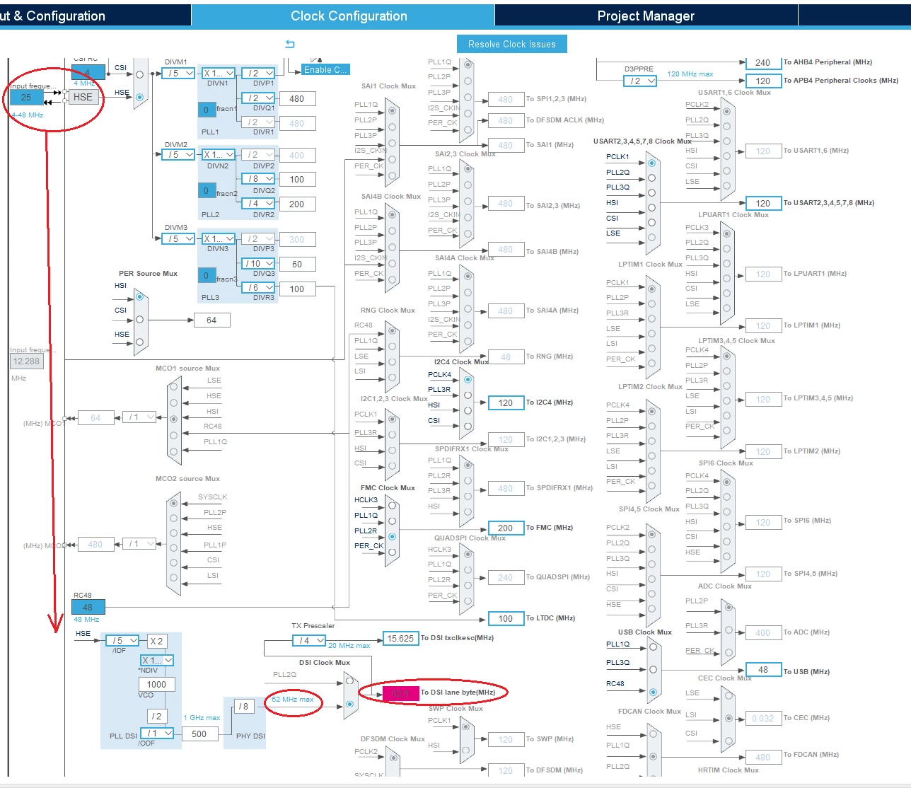

STM32H7 MIPI DSI maximum clock speed?

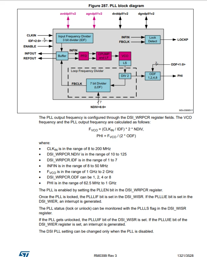

There is inconsistency in the reference manual and the STM32CubeMX clock configuration tool as to what the maximum clock for the PLL DSI. Reference manual suggests it is 1000 MHz however, when set to that in STM32CubeMX, an error is generated at the PHY DSI lane byte frequency with a maximum of 62MHz instead of an expected 125MHz

Not 1 GHz, but 1 Gbps via both edges on both lanes​

Feb 29, 2020 6:59 PM UTC
62 MHz is more of the word delivery clock​
62.5 MHz 32-bpp
83.3 MHz 24-bpp
DSI HOST, 500 MHz clock, signal on both edges, 1x lane 1 Gbps, 2x lane 2 Gbps
2000/24 -> 83.333

Feb 29, 2020 7:28 PM UTC
Yes its DDR on the output clock at but according to the RM the PLL puts out 1GHz. When using those setting CubeMX gives an error so I'm not sure if there is a hardware limitation or just software bug in CubeMX. Don't have hardware yet so can't test at the moment.

Because it's not funnelling BITS into the pipe it's either 16 or 24-bit words for the PIXEL. The 62.5 MHz is the PIXEL clock, the LTDC spits out the data as it paints the rasters, and the DSI needs to move it out at least that quickly.
The DSI PHY clocks at the high rate to push BITS out the LANES, 1 GHz in there is basically 500 MHz on the DSI bus itself.
62.5 MHz / 50 Hz refresh = 1.25 Mpixel

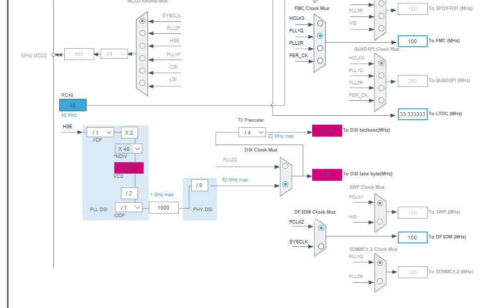

ofer-bahar
Jul 9, 2025 6:08 AM UTC
this is how it looks on the STM32 Cube 1.17.0 MX clock settings
you can see clearly that 62.5Mhz is not allowed in the MX clock configurator !!!
what should a programmer do in that case ??
