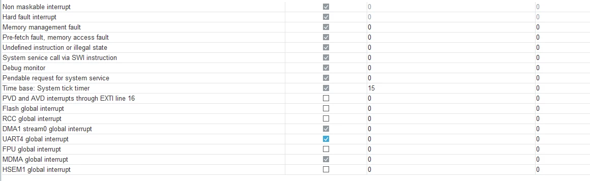

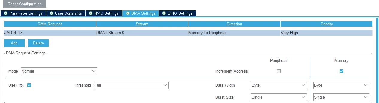

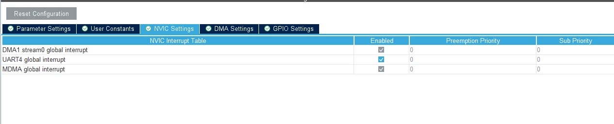

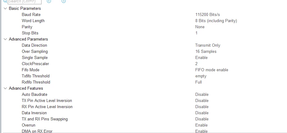

I would like to transfer 3 linked list blocks over UART DMA. When I started HAL_MDMA_START_IT, it transmits only 16 bytes. How can I send big files back to back? Configurations are as follows:
MCU : STM32H7 series
Firmware : Last release

farukisiker
September 17, 2025
I haven't tried that solution yet. Should I close that topic till trying?

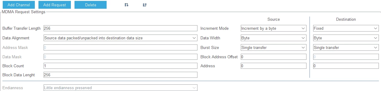

farukisiker
September 29, 2025
In this example, we do not forward all buffers to an interface like UART tx buffer. I already can transfer datas between memory by using MDMA. My problem is with peripheral interface. I want to forward 3 buffers to uart tx buffer back to back.

Hello @farukisiker
Could you please share your code for UART MDMA transfer? The code you shared is for memory-to-memory transfer.
