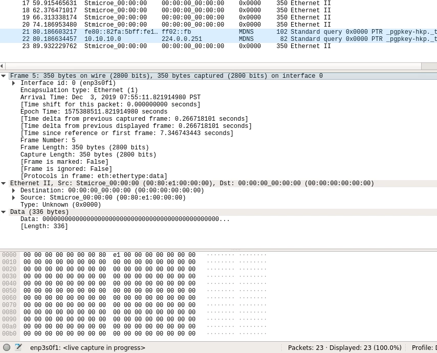

I am trying to setup DHCP over Ethernet using LwIP, with an ultimate goal of using TCP/UDP for communication. I have configured everything through Cube and set up the MPU according to the FAQ guidelines for Ethernet on STM32H7 and am finally receiving/sending packets.
Unfortunately the packets I receive are just raw Ethernet frames w/ no recognizable protocol. I searched around and only found one other post about this and the fix for them was to call LwIP_Process() in the main loop which I am already doing.
Here is what wire-shark is capturing on the interface the stm32 is connected to:0690X00000AtFrjQAF.png

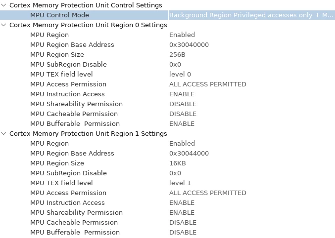

Here is my MPU Configuration:
I have also attached my IOC file, any help will be greatly appreciated.

And what address is it *actually* using for the buffers, not just the descriptors.
Perhaps make the memory area larger, and make sure you commit any data with a fencing instruction, or explicit flush. ie __DSB, and SCB_CleanDCache_by_Addr()

Oh this was it, the Txbuffer in low_level_output was on the stack and was being cached. Adding SCB_CleanInvalidDCache() before calling HAL_ETH_Transmit(....) in ethernetif.c fixed the issue for me.
Just wondering if there is a better way to do this without touching generated files (unfortunately there is no /* USER CODE */ section in low_level_output)

NVM got it, just used the MPU to setup the stack/heap area as Write Through RW Allocate and it works
