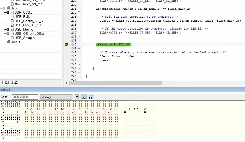

Hi, I am using V1.2.0 of stm32h7xx_hal_flash_ex to erase individual sectors. Directly after the erase cycle I do a blank check which reports errors. When setting a breakpoint I can see in the debugger that effectively the flash is not empty:
When stepping the flash contents updates and then it is completely erased.
I have tried with different voltage range settings but nothing helps. What could be the issue here?
Thanks,
Andre

Hello Andre,
1/ Does the HAL API HAL_FLASHEx_Erase() report a HAL_ERROR or HAL_OK?
2/ Is Cache activated in your application?
In fact, when cache is activated, the CPU could be seeing an old data available in cache, and not the new data available in flash memory. So, a cache maintenance in needed after erase.
