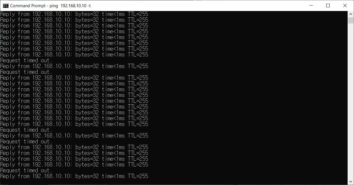

Dear Imen,
Thanks for your replay.
I modified my project file using your new library file(ethernetif.c)
And I was testing during two days.
But, It has a problem yet.
Previously, there was stop the ethernet in minutes.
But, there was stop the ethernet in hours about 2~5.

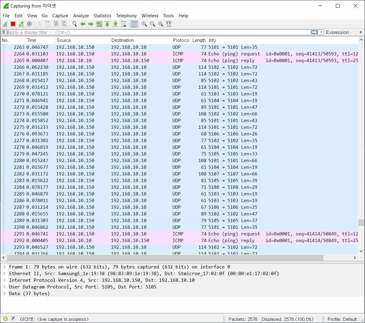

My application is to convert UDP to SERIAL.
UDP packets per a second cycle are approximately 25 ~ 30.
There is a PING every second at the same time.
I captured the PING result below.
And after a few hours, the response is stopped.
 Merry Christmas and Happy New Year!

Do you use FreeRTOS, and when which settings do you have?
(Thread and stack size)
Are you sending UDP packets with netconn API?

Yes, I use the FreeRTOS. And I use the function of socket API.
(configTOTAL_HEAP_SIZE is 128KB. and UDP_RX_TASK stack is 512)
I was setting that cache is disable.
Ethernet is stop. but other tasks are good running.

Is it possible to ran out of memory after 2-5 hours?
Print the result of the RTOS function xPortGetFreeHeapSize() to determine how many bytes are available.
You can also enable the statistics of LwIP and take a look at the peaks.
