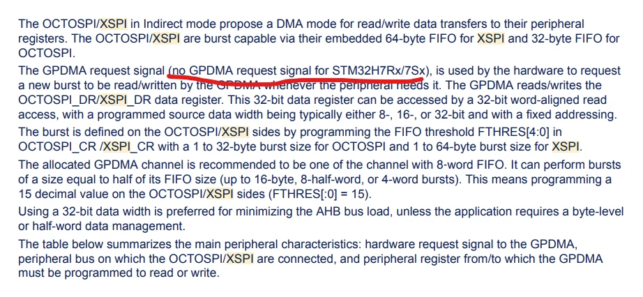

In STM32H7 MCU FW, i am implementing the GPDMA transfer to XSPI in indirect mode, updating DR Register from FW with DMA. I have a custom x8 SPI DDR Slave as target. The issue is i am getting Data transfer error during the HAL_DMA_Transmit_IT function. I have refered the app note for GPDMA - AN5593 where it is mentioned as -
on page 38.
I am using SW based trigger to dma since there is no GPDMA req signal for xspi for STM32H7. I want to know
  • how to implement software-based trigger if gpdma req signal is not present. I have mentioned the code below.
  • IF there is any workaround to fix the HW DMA req signal issue from xspi?
  • If not then on what other STM device having min of 2 - x8 spi support proper GPDMA transfer with HW DMA req implementation.
  • Code used in my application is mentioned below -

static HAL_StatusTypeDef XSPI2_StreamChunk_DMA32(const uint8_t *src, uint32_t timeout_ms)
    uint32_t t0 = HAL_GetTick();
    if (src == NULL)
        return HAL_ERROR;
    /* Require 4-byte alignment for WORD DMA */
    if (((uint32_t)src & 0x3U) != 0U)
        return HAL_ERROR;
    g_xspi2_dma_error = 0U;
    g_xspi2_dma_busy  = 1U;
    if (HAL_DMA_Start_IT(&hdma_xspi2_tx,
                         (uint32_t)src,
                         (uint32_t)&hxspi2.Instance->DR,
                         32U) != HAL_OK)
        g_xspi2_dma_busy  = 0U;
        g_xspi2_dma_error = 1U;
        return HAL_ERROR;
    while (g_xspi2_dma_busy)
        if ((HAL_GetTick() - t0) > timeout_ms)
            (void)HAL_DMA_Abort(&hdma_xspi2_tx);
            return HAL_TIMEOUT;
    return (g_xspi2_dma_error == 0U) ? HAL_OK : HAL_ERROR;
