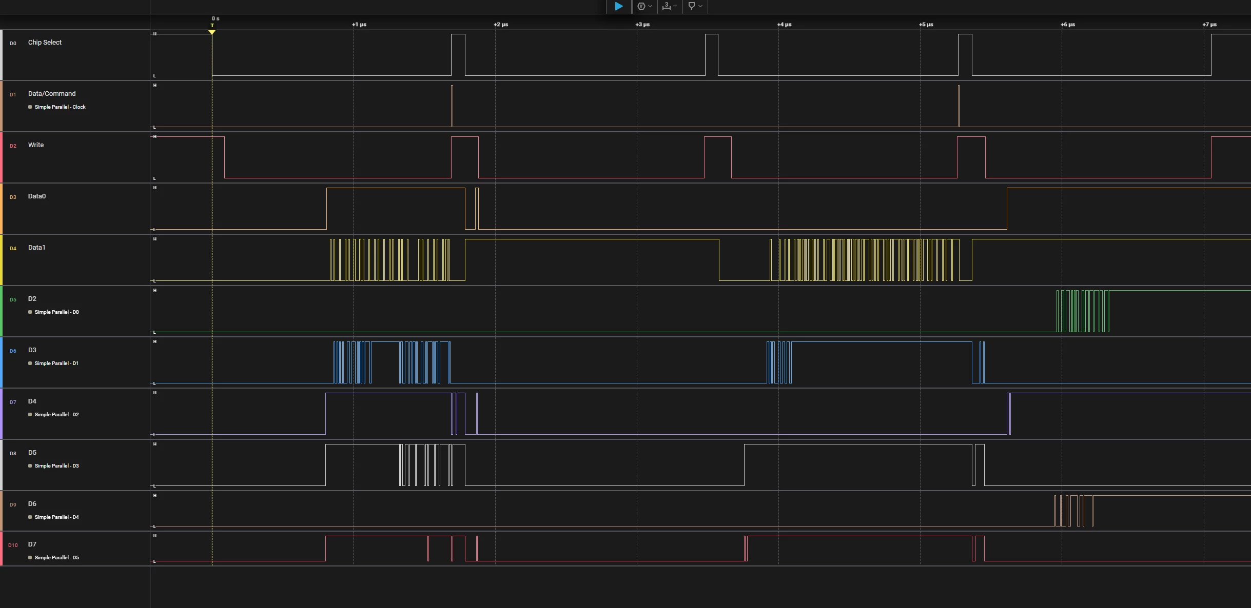

I am trying to interface Stm32h745 controller with a 240x320 TFT LCD over FMC. Interesting thing is, when I manually control lcd control and data pins(Set them as GPIO_OUTPUT_PP), Lcd works, but when I switched to FMC it does not. Tried lots of timing configuration but it did not help.

Tried FMC peripheral clk from 240 Mhz down to 15Mhz
LCD command/data selection connected to A0, and I am bank swapping from0x60000000 to 0xC0000000
#define LCD_BASE_ADDRESS ((uint32_t)0xC0000000)
#define Lcd_CmdWrite(cmd)	 *((__IO uint8_t*)LCD_BASE_ADDRESS) = cmd
#define Lcd_DataWrite(data) *((__IO uint8_t*)((LCD_BASE_ADDRESS) + (1 << (0 + 1)))) = data
 Here is the Logic Analyzer screen for 160Mhz Fmc Clock for the sequence below

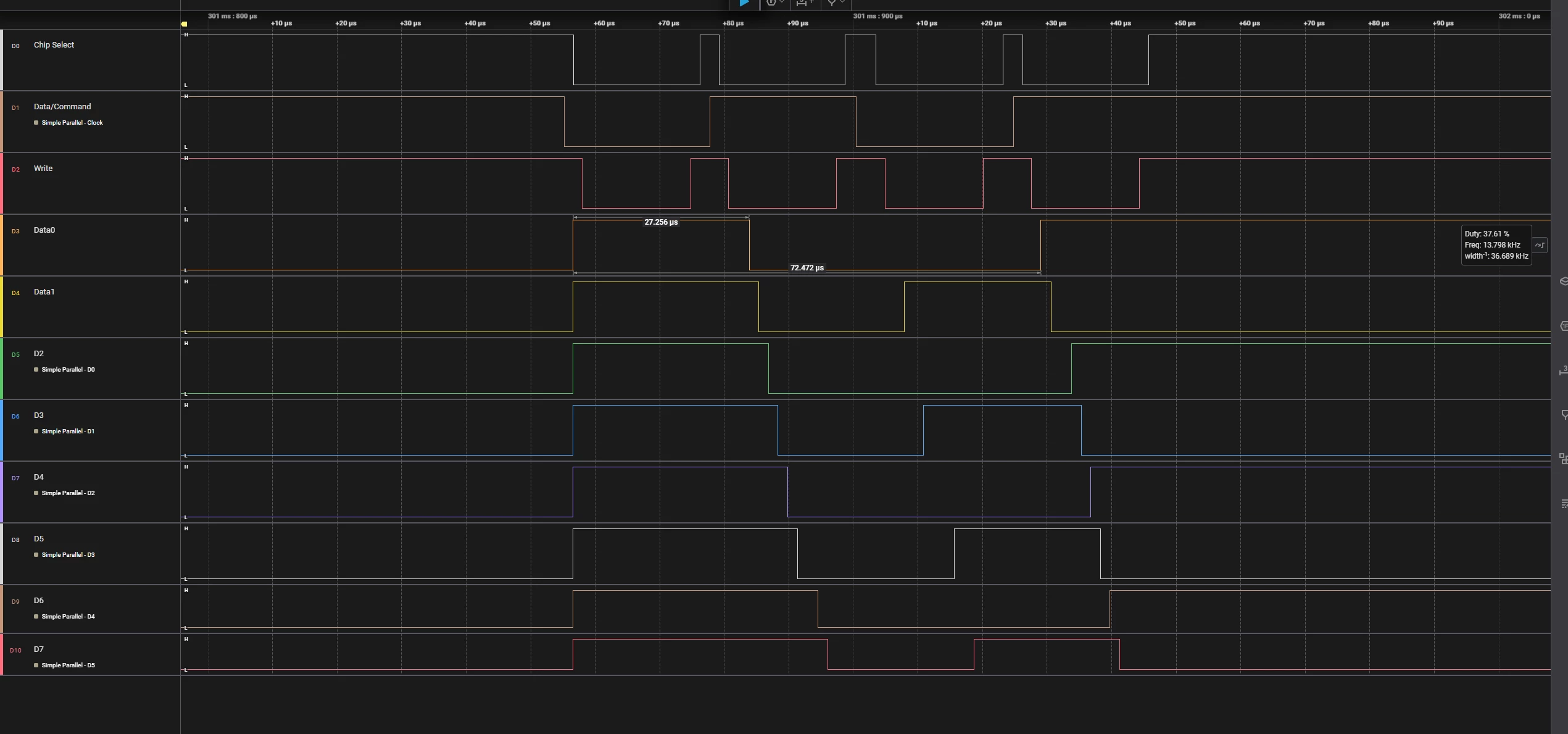

And here is the same saquence output with manual GPIO Control
