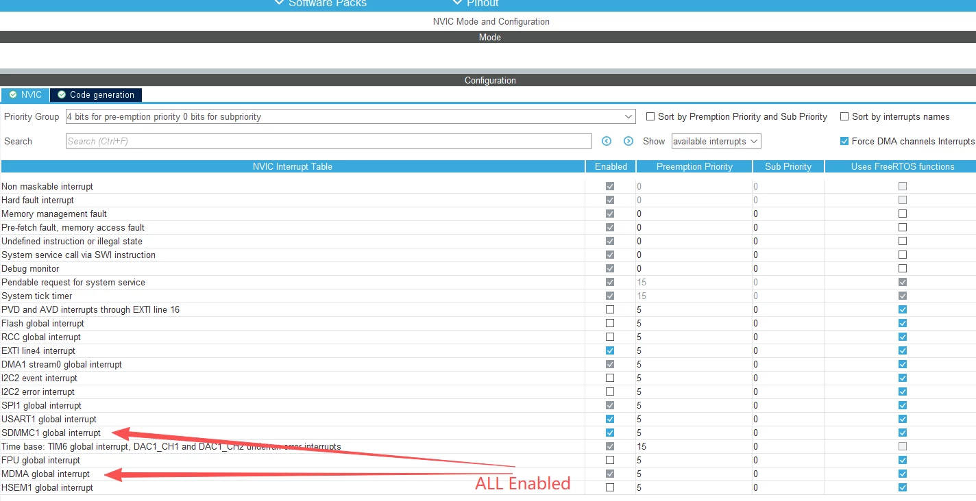

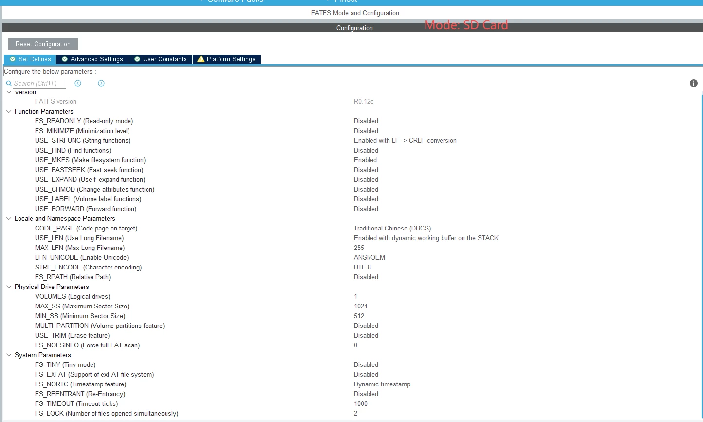

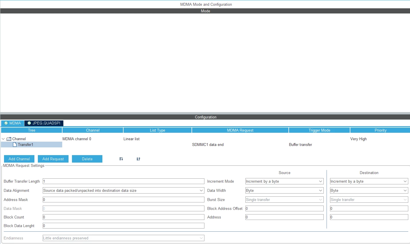

Is there something wrong with the configuration of my STM32cubemx? Here are pictures of my various configurations

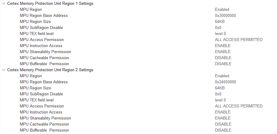

I have enabled D-Cache, but I managed the MDMA_buf address with an MPU to prevent D-Cache from accessing it. My LCD's DMAobuf also works this way, so there is no problem

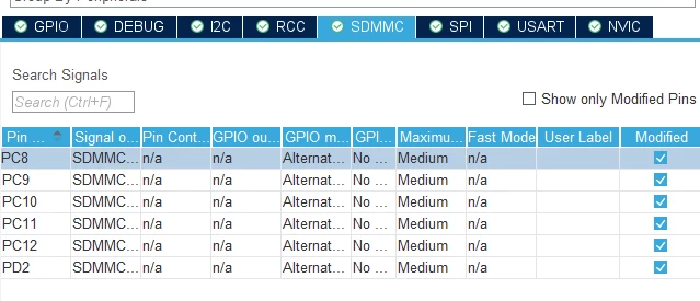

>I have already confirmed that the hardware and SD card itself are working because the previous bare-metal implementation can mount and read the same SD card successfully.
So hardware seems ok/working, just : what pin speed setting is used now, vs your previous version ?
  • I found it often working only at pin setting: medium speed + pullups ON (all lines to sd-card).
  • set sd-clock 50 MHz  (50MHz is standard maximum)

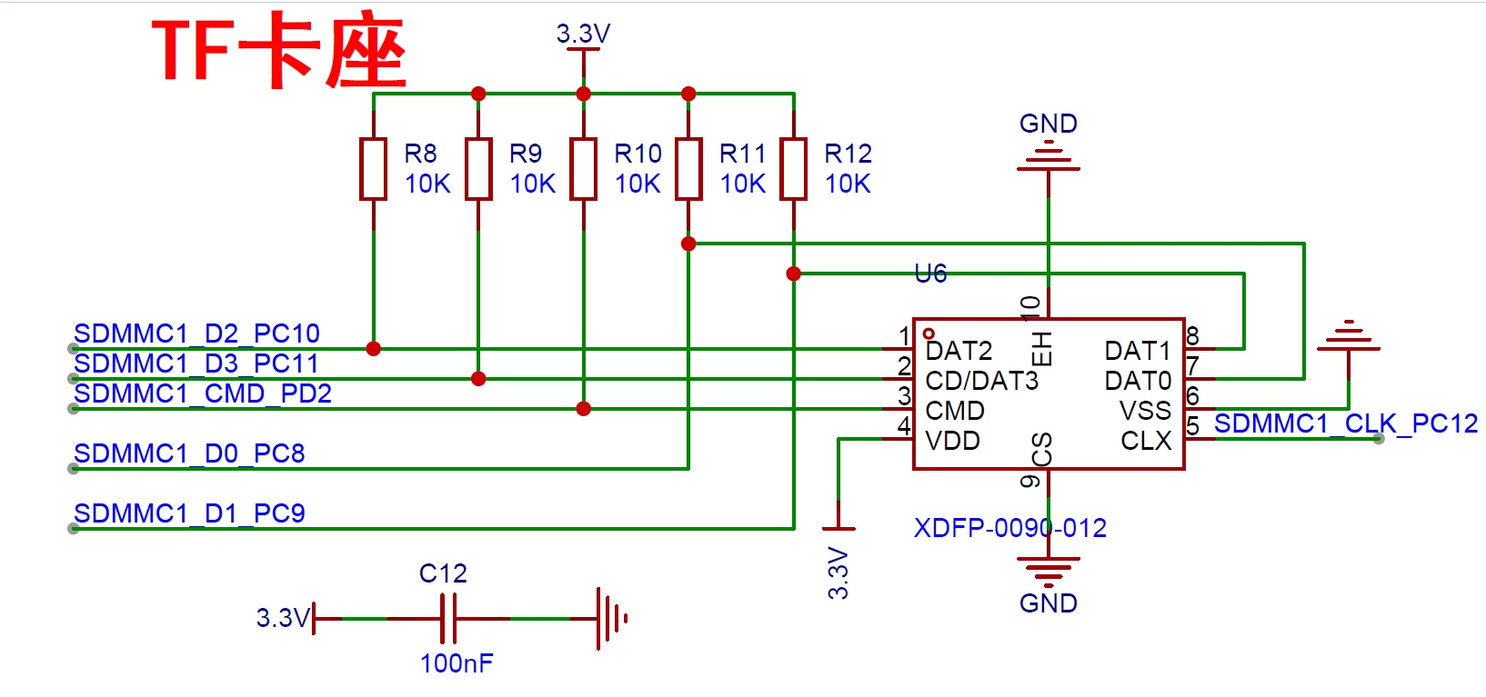

Hello AScha.3:
​This is my circuit diagram and GPIO pin configuration.There is an external pull-up on my circuit diagram, and I have tried to reduce the speed to medium speed, but it still doesn't work. I have also tried turning off both MPU and D-ACHE, but it still doesn't work

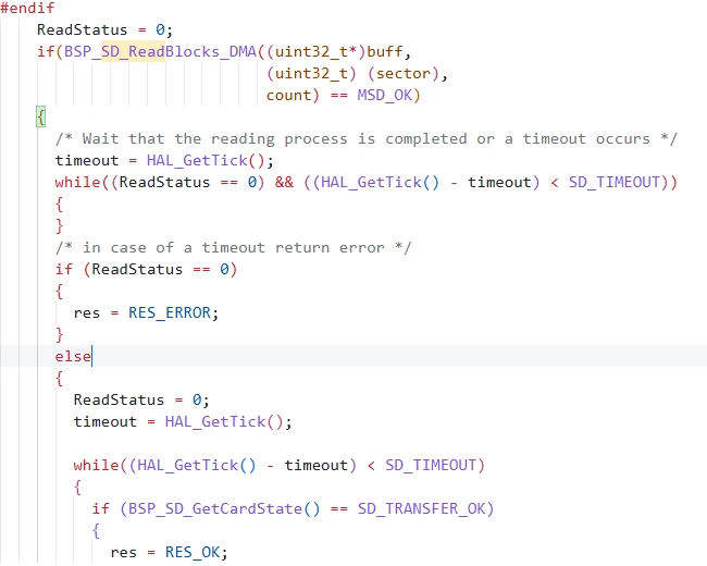

I've been stuck here since I debugged, and the comment says /* Wait that the reading process is completed or a timeout occurs*/  That is to say, reading failed, resulting in timeout and return error
Is there anything in the BSP_SD_SeadBlocks_DMA() function that I haven't modified

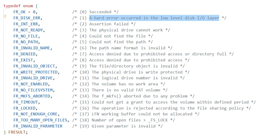

Hello Andrew Neil :

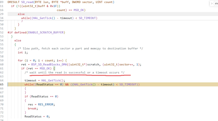

I found out what the return value of the function f_mount () represents. It returns an enumeration definition of type FRESULT, and returning 1 indicates a hardware error has occurred. I searched down and found that the problem was in the SD_dead() function
This part of the code has been waiting for ReadStatus to be set to 1. I checked and found that it is set to 1 in the callback BSP_SD_SeadCpltcallbacks (), which is called by HAL_SD_RxCpltcallbacks (). The top-level call is made at HAL_SD_IRQHandler() in stm32h7xx_it. c. That is to say, the MDMA interrupt callback did not execute, so ReadStatus remained at 0.
I asked ChatGPT and it told me about this post
I will follow the instructions in this post to set ReadStatus=0; Putting it in front of BSP_SD_SeadBlocks_DMA() still doesn't work

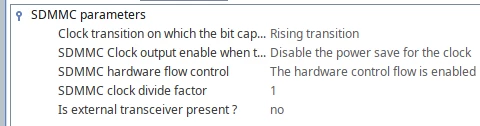

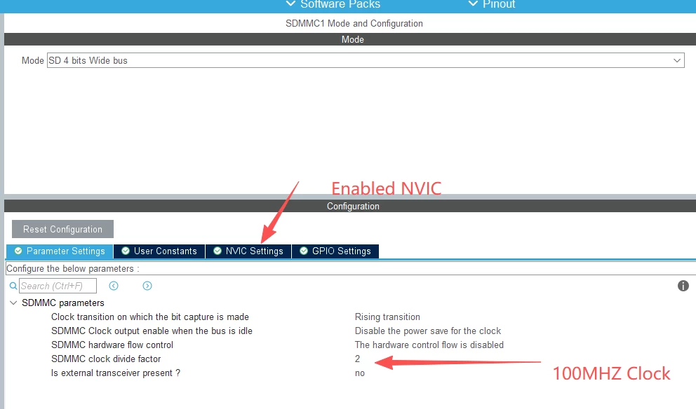

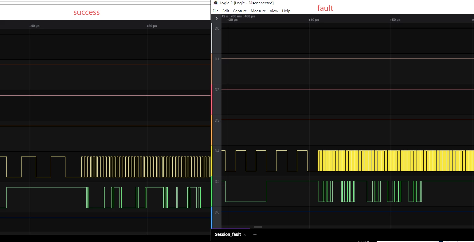

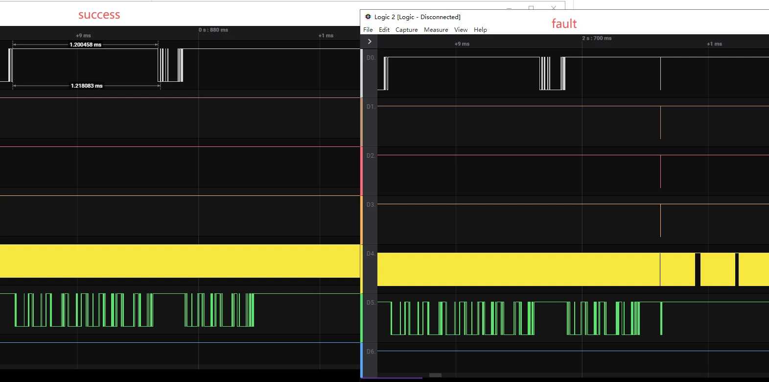

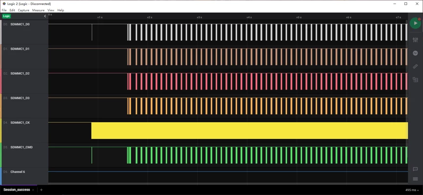

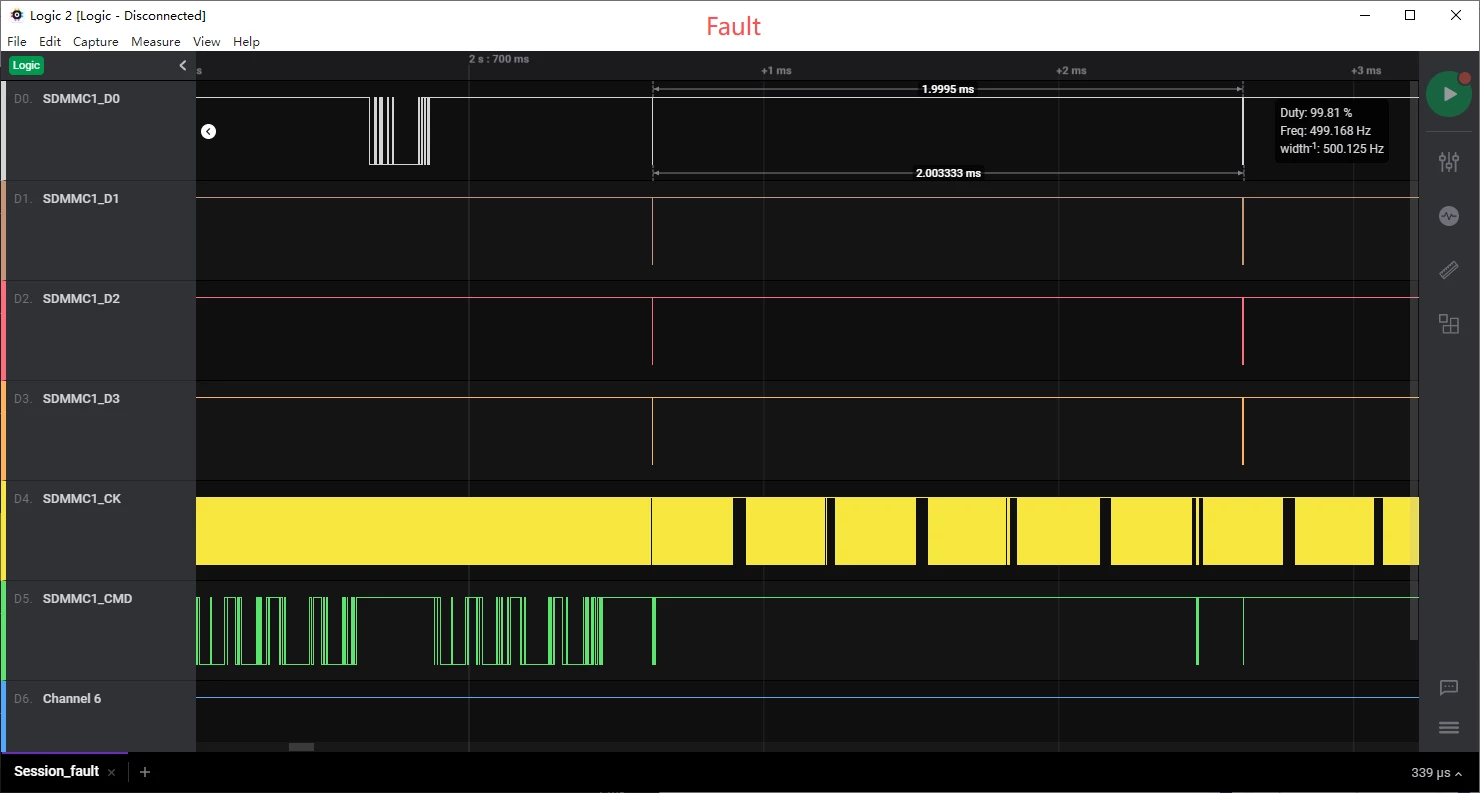

My previous bare metal routine SD_COCK was set to 20MHz, so I modified the current version to also set SD_COCK to 20MHz (bus clock set to 120MHz, frequency division set to 3), SD_CLOCK=120/(2*3)=20Mhz ), Then I used a logic analyzer to capture the signals of these two versions
SUCCESS:
FAULT:
I found that the CK signal and CMD signal in front of them are the same, except that the CK signal cycle of the Success version is 250us and the CK signal of the Fault version is 83us.
After 700ms, the Success version was able to retrieve the contents of the SD card normally, while the Fault version waited for ReadStatus to be interrupted and the callback function to be set to 1
It seems that there is a timing issue with the CK and Data signals in this Fault version
I don't understand why this problem occurred. I have tried to modify it according to the post, but it still hasn't been successful. Or is there a problem with my stm32cubemx configuration

Now I am migrating the project to a FreeRTOS environment, where MDMA is required for SDMMC. The main difference is that, with FreeRTOS, the SD card must be mounted after the FreeRTOS scheduler has started, so the mounting process needs to be performed inside a task.
I also rely on the MDMA interrupt callback to determine whether the SD card operation has completed successfully. However, I am currently stuck at the MDMA stage because the interrupt callback is never triggered.
Therefore, I suspect there may be a configuration issue with MDMA, SDMMC, or the related interrupt settings.

​@SimpleMa ,
i forgot :
  • try without D-cache, MMU
  • and no DMA
  • and SD 1-bit mode
these been my settings : (but with Azure Rtos + Filex , but similar to freertos + fatfs )
(clock → 50M )
