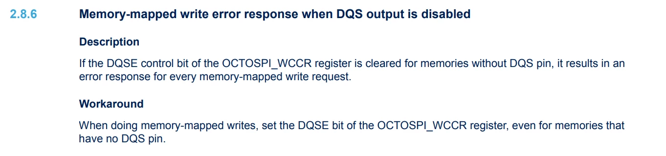

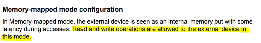

Hello @JShih.2 ,
Are you use the OCTOSPI interface for STM32H723?
It is mentioned in the STM32H723 datasheet section 3.18 Octo-SPI memory interface (OCTOSPI) that: "Memory-mapped mode: the external memory is memory mapped and it is seen by the system as if it was an internal memory supporting both read and write operations."
Also, in RM0468
Note that, when doing memory-mapped writes, set the DQSE bit of the OCTOSPI_WCCR register, even for memories that have no DQS pin (please see STM32H72xx/73xx device errata - Errata sheet section 2.8.6 Memory-mapped write error response when DQS output is disabled.)
Please refer at these examples for write operations: OSPI_NOR_MemoryMapped_DTR and OSPI_HyperRAM_MemoryMapped.
Thanks and best regards,
Kaouthar
