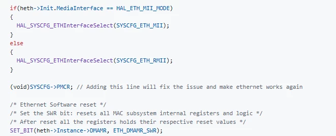

GLIU.1
July 7, 2025
Hello
I would suggest you:
1/ add below SYSCFG->PMCR to check if any improve? under stm32h7xx_hal_eth.c
2/ double check MCU PA1 pin (RMII_REF_CLK) thru oscilloscope if have right clock input?
thanks!

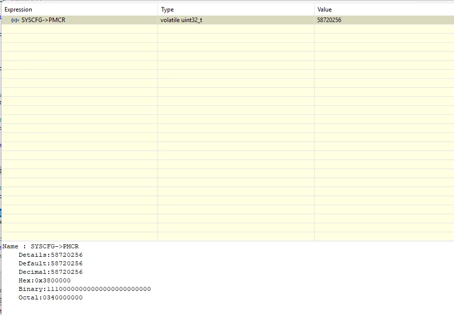

July 7, 2025
1- SYSCFG->PMCR was in Code and the Value is:
2- I try to get oscilloscope
