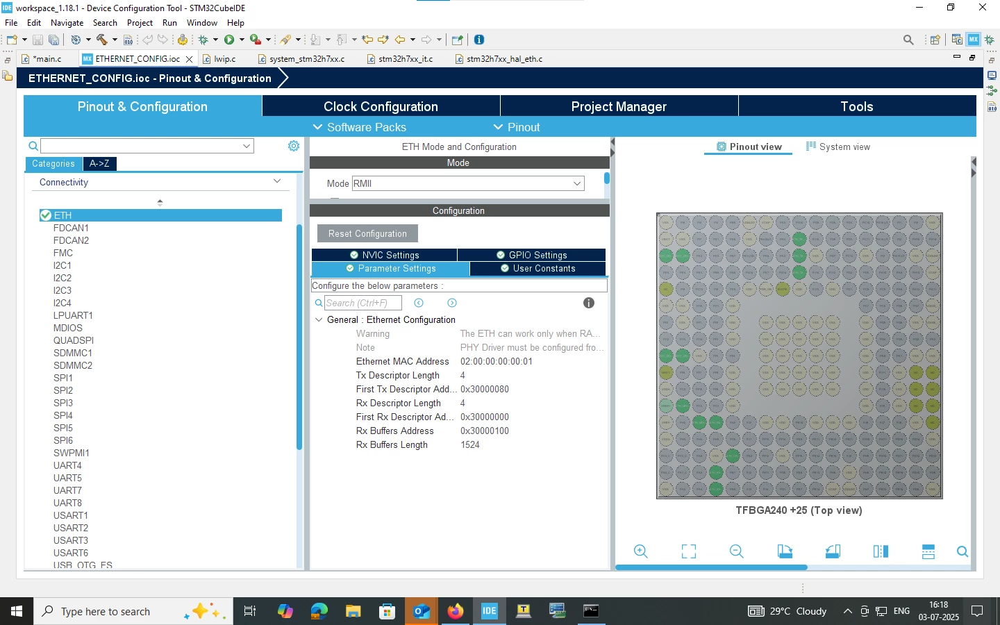

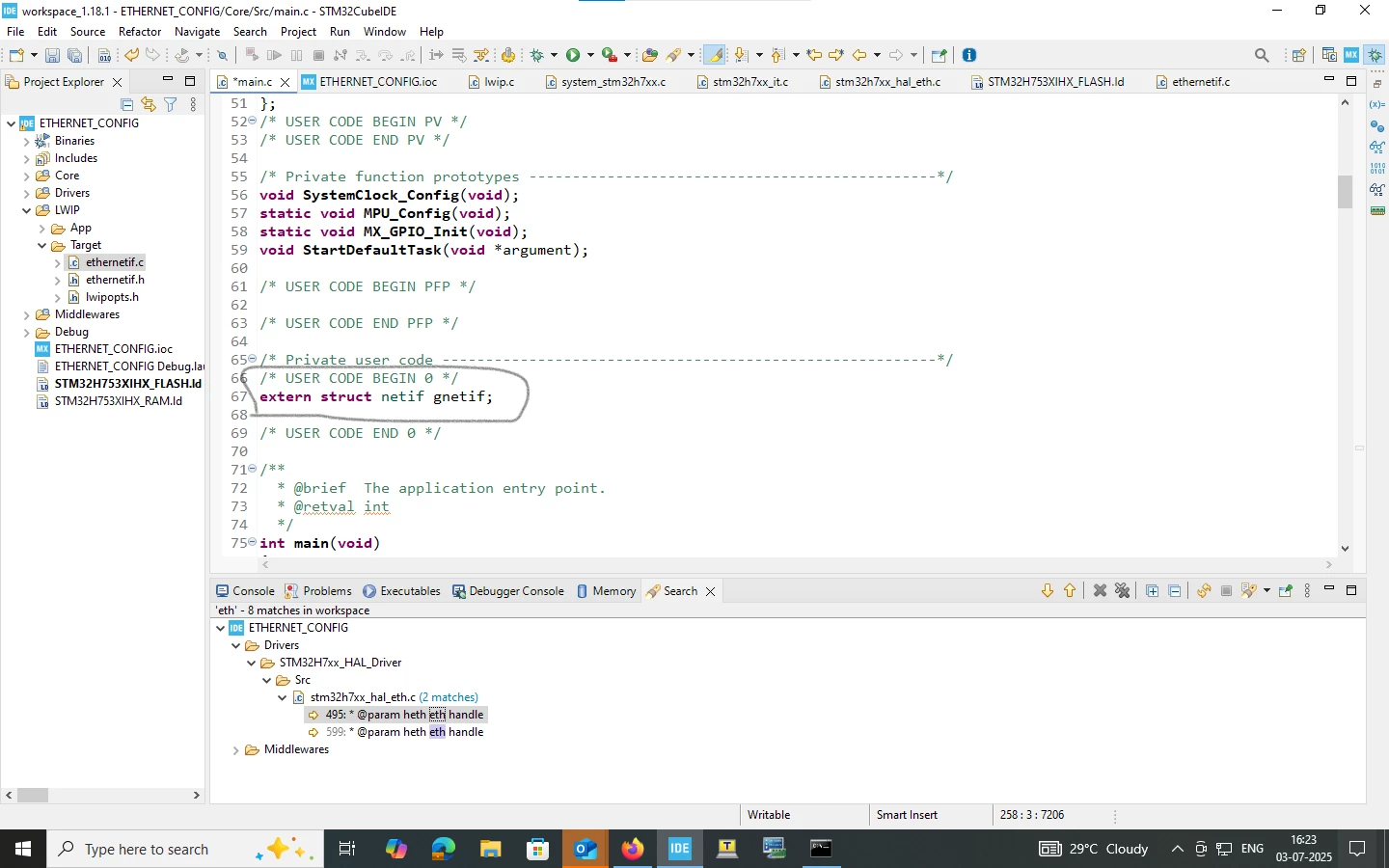

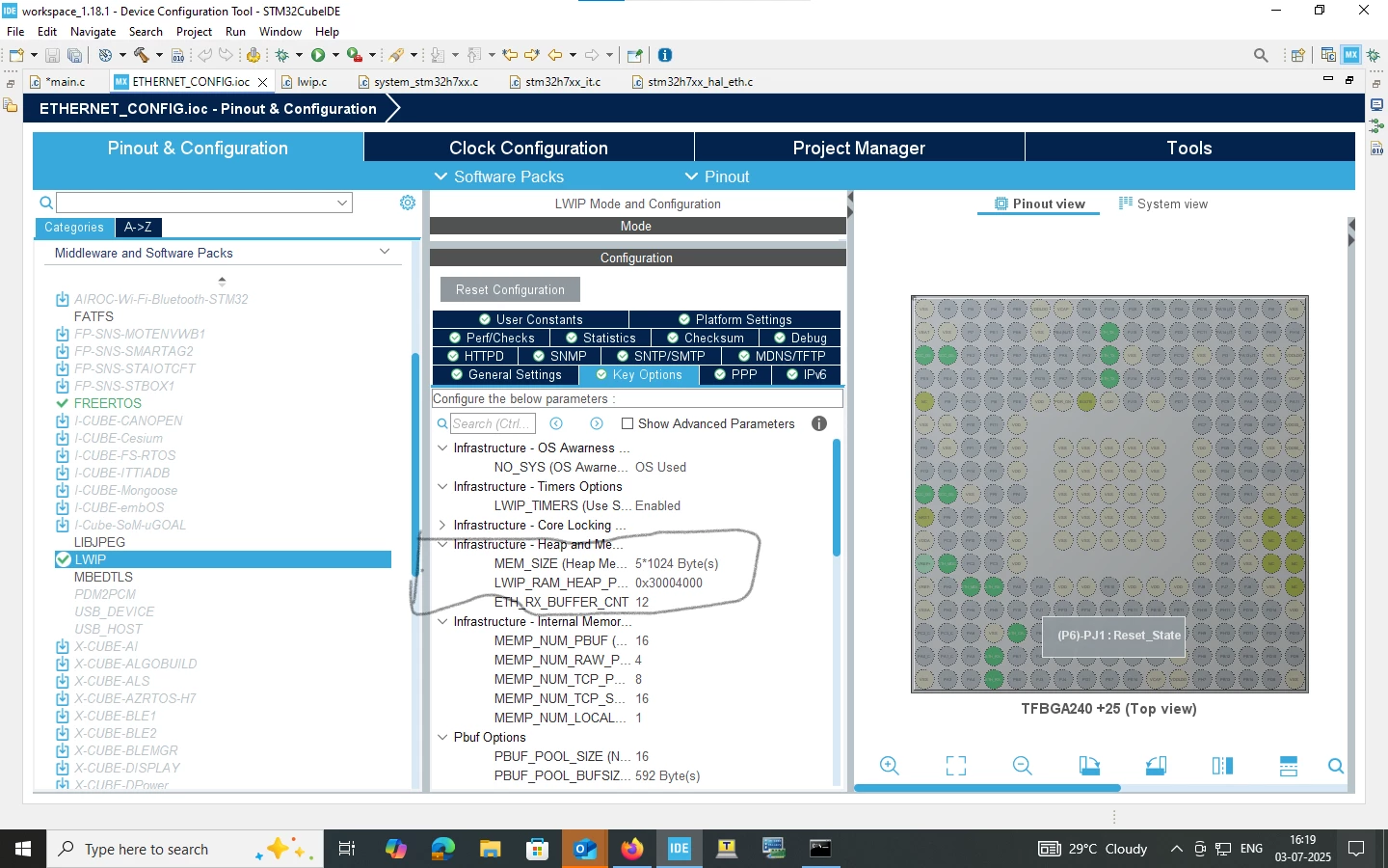

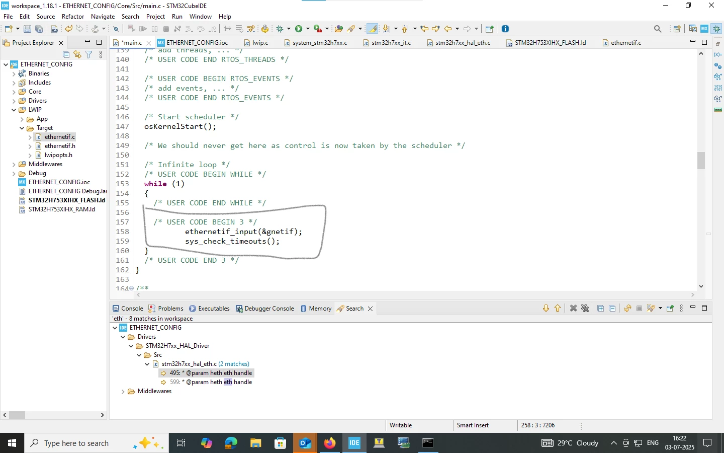

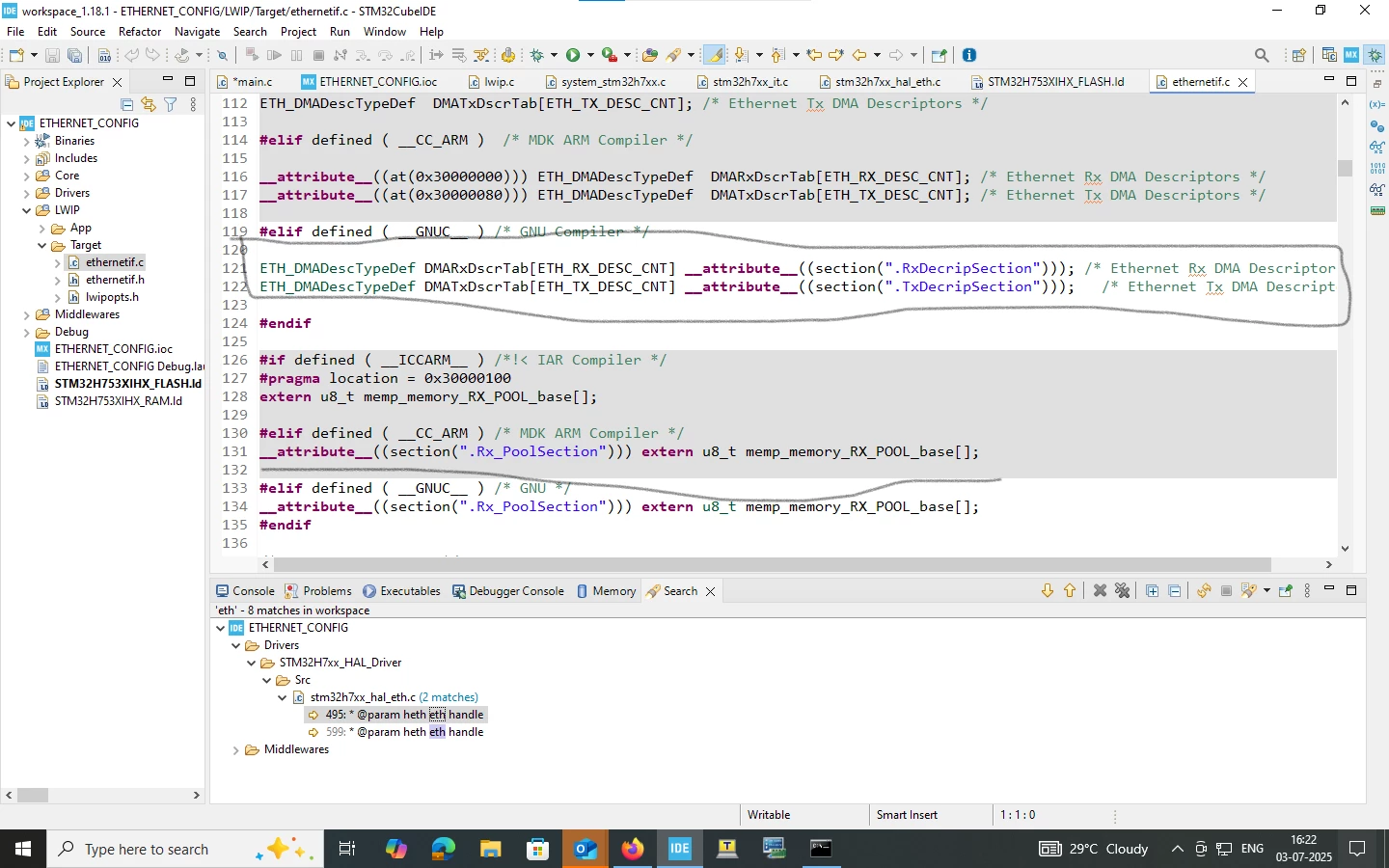

rockey1Author

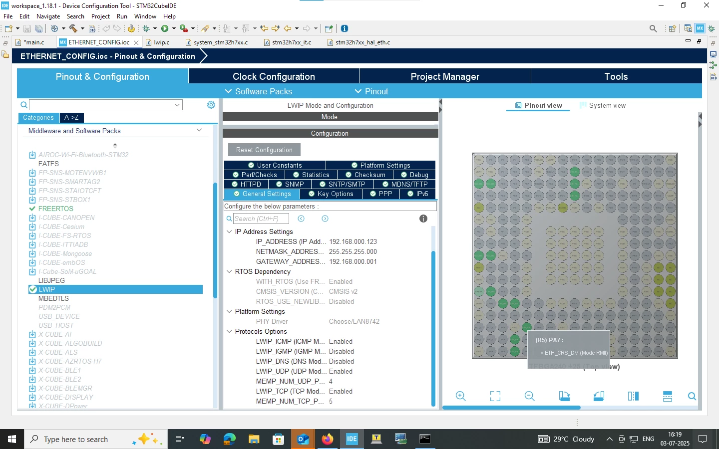

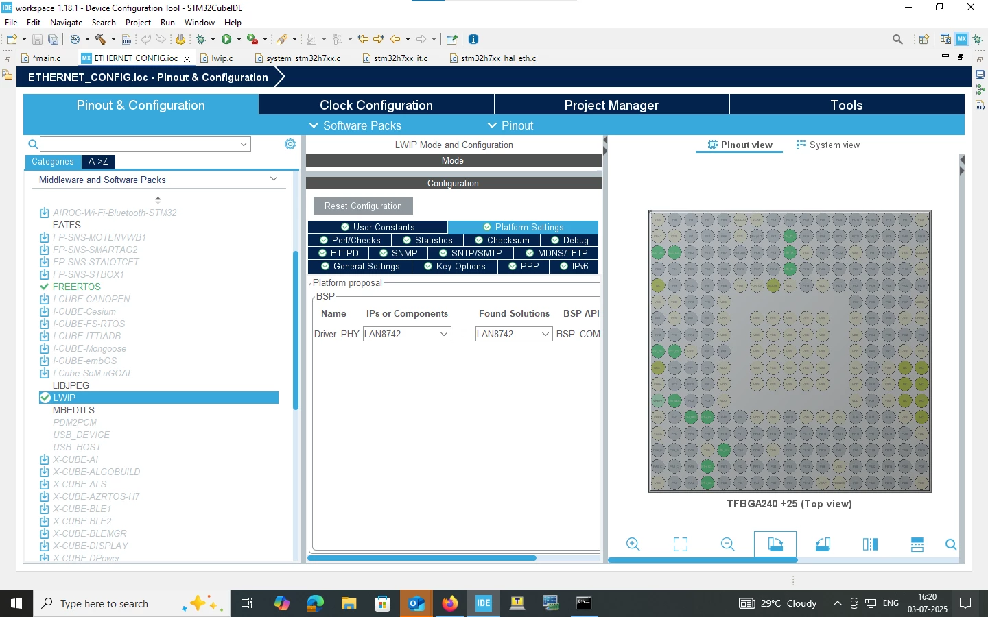

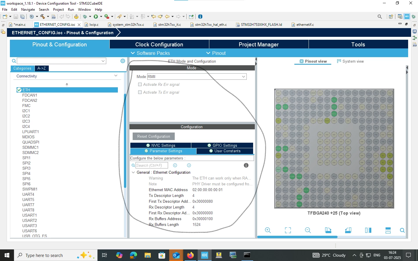

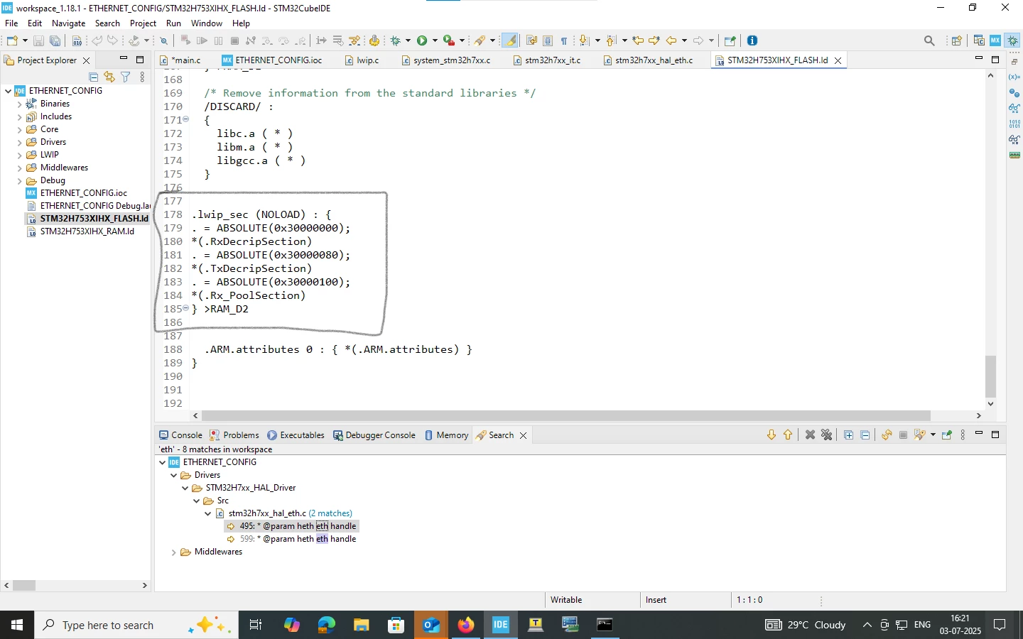

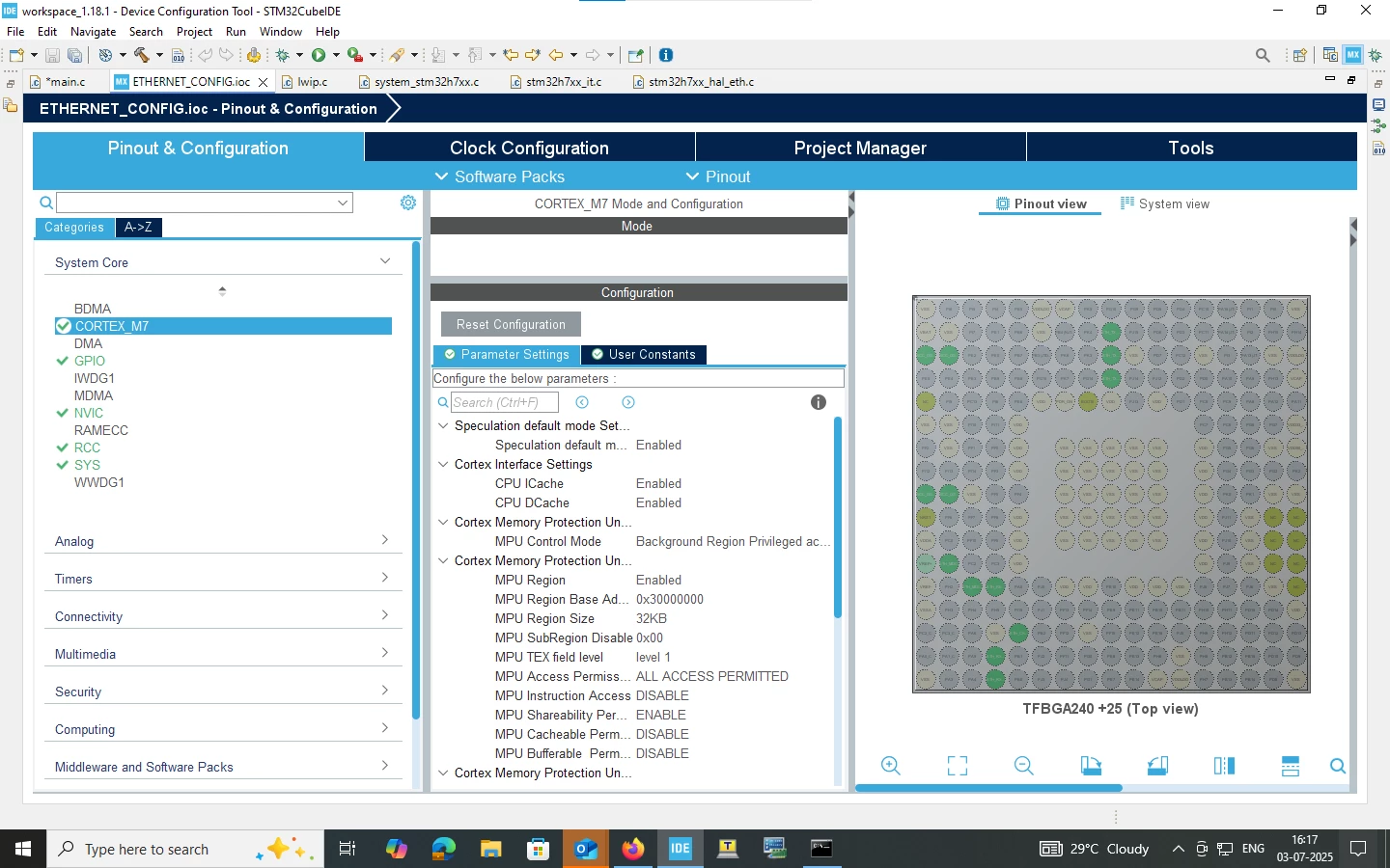

July 3, 2025
Screenshot 2025-07-03 161748.pngScreenshot 2025-07-03 161829.pngScreenshot 2025-07-03 161920.pngScreenshot 2025-07-03 162000.pngScreenshot 2025-07-03 162027.pngScreenshot 2025-07-03 162125.pngScreenshot 2025-07-03 162241.pngScreenshot 2025-07-03 162305.pngScreenshot 2025-07-03 162330.pngScreenshot 2025-07-03 162422.png

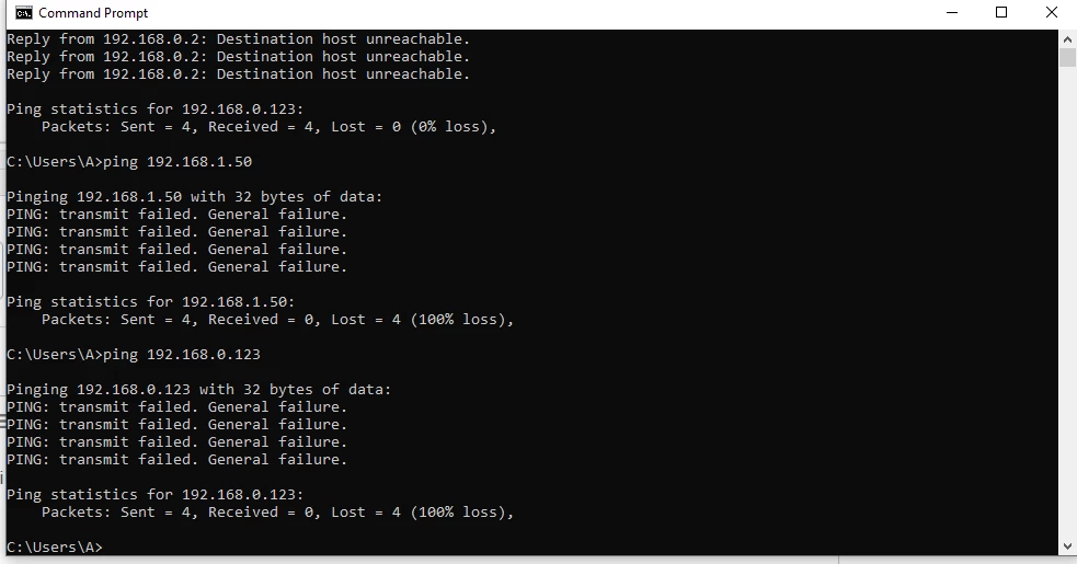

rockey1Author
July 3, 2025
this config and code i am using to run eternet in my stm32h753xi6 chip i am getting this output when i am ping ipScreenshot 2025-07-03 163025.png
rockey1Author
July 3, 2025
i need a conection between my pc or stm32h753xi6 chip or ping that stm 32 ip and response that is ping that i want only.
