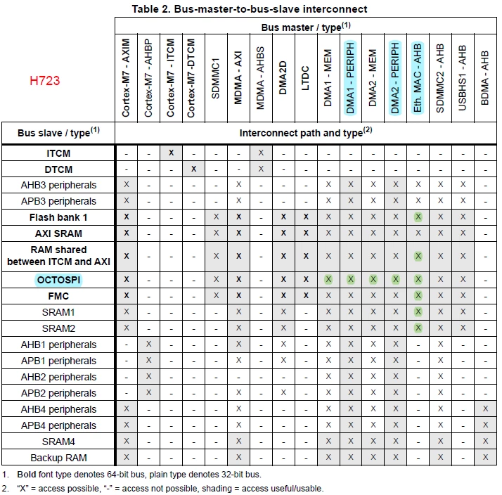

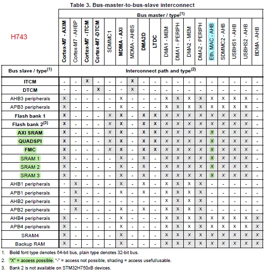

ETH likely cannot access it. Consider that ETH has its own master DMA, it does not use the DMA controllers of the STM32. See the bus matrix pictures in the RM.

I think the H743 does not support memory-mapped QSPI SRAM.
Just found it in the RM0433, pg. 895:
"Only read operations are allowed to the external Flash memory in this mode."
And I only read "Flash" all the time... ;)
Concerning DMA / memory access:
What about the Dx-to-Dy AHB bridges, these cannot be used by the DMA controllers?
If these are working, are they slowing things down ?
The thing is that the RMs show that access from SAI (DMA2) and ETH DMA is possible, but from users I read differently.
Here's the interconnect matrix for the H723+:
0693W00000WLOlzQAH.pngHere for the H743:
