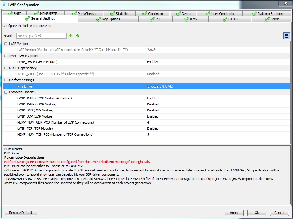

Hai , Now we are using the STM32H7 MCU in our board instead of the STM32F7 MCU .For ethernet in the STM32F7 phy drivers are given by  the stm during the generation (by cubemx) only but for the STM32H7 phy drivers are not  available . how to select the phy address in STM32H7 .

Hello
maheshwarreddy681
For STM32H7, theLAN8742 PHY driver is configured from the LwIP >
Platform Settings
tab, then CubeMx copies lan
8742
.c/.hfiles from the CubeH7 firmware package toyour project directory and you canmanage thePHY setting.

Hello   Lmen  D ,
                           Thank you for the valuable reply , I had changed the Phy settings as mentioned above still the Ethernet is not working i.e i'am unable to send the Packet out . Is their any special clock settings are needed for the Ethernet.

Posted on March 28, 2018 at 18:38
https://community.st.com/0D50X00009XkWXJSA3
You cannot set the PHY address.
In lan87c is a for loop which starts at address 0 and tries to find a device until addr=
Take care of the RAM settings, do not use DTCMRAM.
I had some articles about that in this forum.
