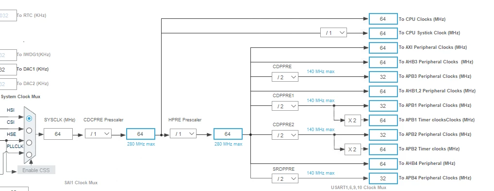

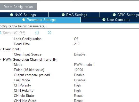

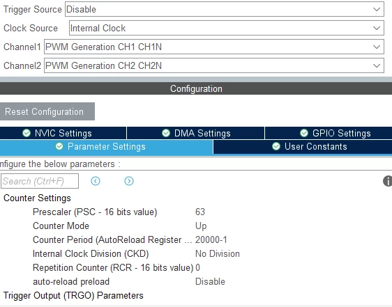

Hello everyone,
   I need your help for configuring PWM dead time, I have configured below configuration but I received dead time as 5uS. I need 200uS dead Time. Could you please help me.
