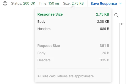

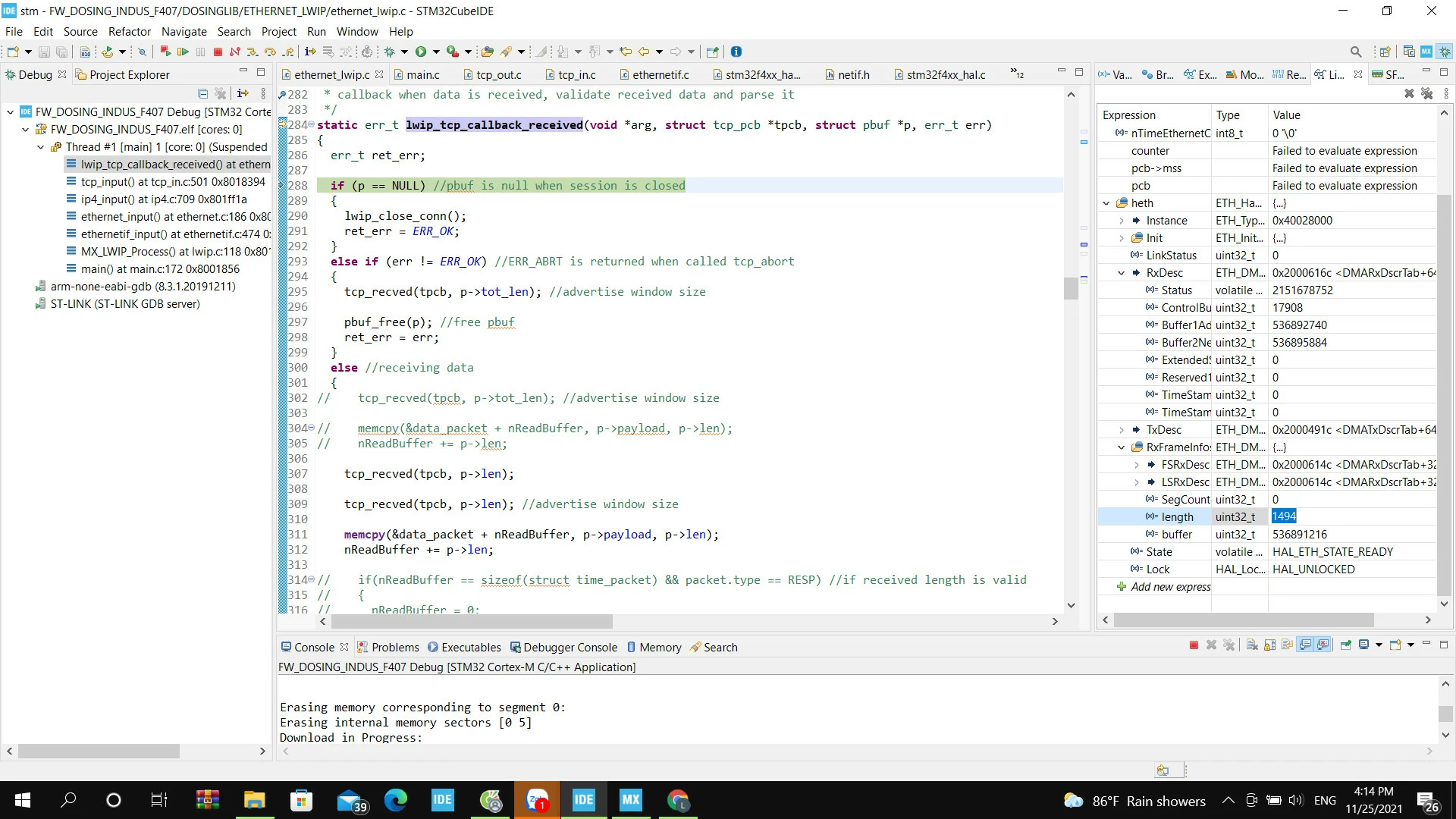

Thank you so much for this! But can I ask some little questions cause I'm so new to LwIP. Have you ever tried to receive a packet that has a size larger than TCP_MSS yet? I can not receive the whole response from the server (2.75KB), I just received only 1440 Bytes. Are there any ways to receive full the response data? Can someone help me with this?

My homepage is 2.5k in size, I am sending it with the code below.
I am using socket communication.
void BulkWrite(int conn,char *Buffer,int size)
  if(size<1400)
    write(conn, Buffer, size);
  else
    write(conn, Buffer, 1400);
    BulkWrite(conn,&Buffer[1400],size-1400);
