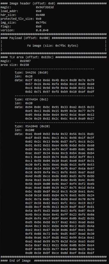

Also I took a dumpinfo of the signed firmware binary file using this command (imgtool dumpinfo C:/Users/Naveen/Documents/Project/build/zephyr/zephyr.signed.bin)
In Image header I observed that the field protected_tlv_size  = 0, does this means the firmware isn't signed properly?
What could be the root cause of the issue, why BL doesn't jump to application? I'm new to zephyr. It would be great if some one help me out here
