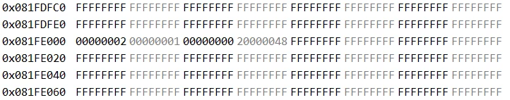

STM32H573 Flash Memory did not retain the data after reset and power cycle
I am using the STM32H573I-DK eval board.
I can able to write and read the data in flash memory (sector 127). But after resetting or power cycle it does not retain the data. that sector fills with 0xFFFFFFFF only.
how do fix this issue?

Jun 19, 2024 3:54 PM UTC
Hello @Mathan Raja
This is due to a power loss during a Flash memory operation. If a reset or power down occurs while a Flash operation is in progress, such as programming or erasing, the contents of the Flash memory being accessed may become corrupted. This is because the Flash programming is interrupted, leading to potential corruption of the erased or programmed memory page.
In order to give better visibility on the answered topics, please click on 'Best answer' on the reply which solved your issue or answered your question. Saket_Om
Tesla DeLorean
Guru
Jun 19, 2024 4:45 PM UTC
How does this compile?
if (HAL_FLASH_Program(FLASH_TYPEPROGRAM_QUADWOD, FLASH_STORAGE_1 + i, (uint32_t)data) != HAL_OK)
Should get a syntax error.
What's the "data" structure look like here?
Strikes me that it in fact gets an error and exits early
Not sure what's supposed to get written and what actually does.
Instrument the code so you know if it succeeded, irrespective of subsequent actions.
Check the content before you reset. Don't reset until all write buffers have cleared.
Printing content to the console can provide validation.
Mathan Raja
Mathan RajaAuthorBest answer
Jun 20, 2024 6:43 AM UTC
This is my code now. It is working fine. this can retain the stored value after reset and power cycle.
thanks
Mathan
