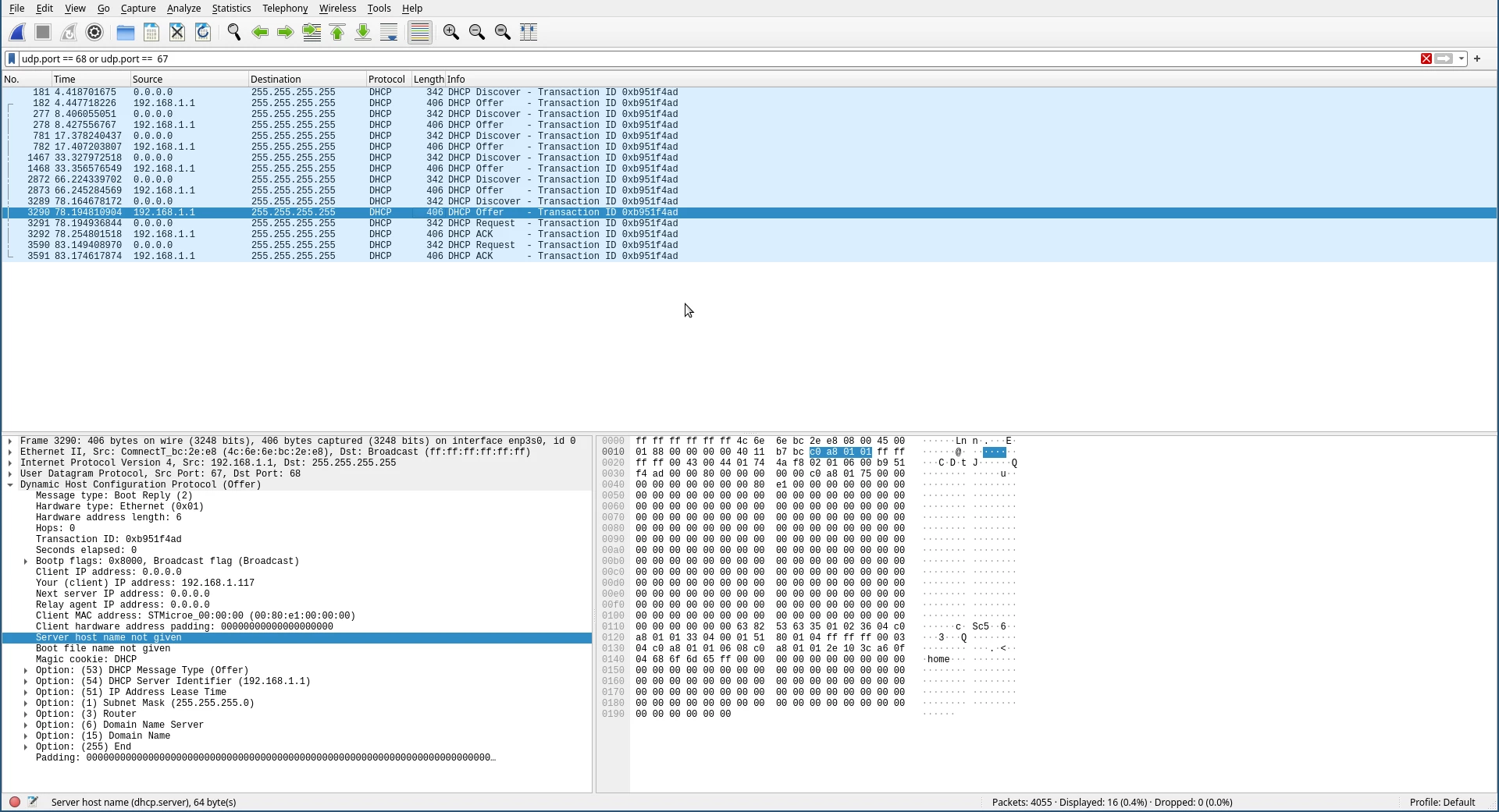

I am developing on the NUCLEO-H563ZI board a system in which I need to obtain an IP address via DHCP.
I have implemented the client following the guidelines of the documentation provided by ST as well as THREADX and NETXDUO and, I have strange behavior.

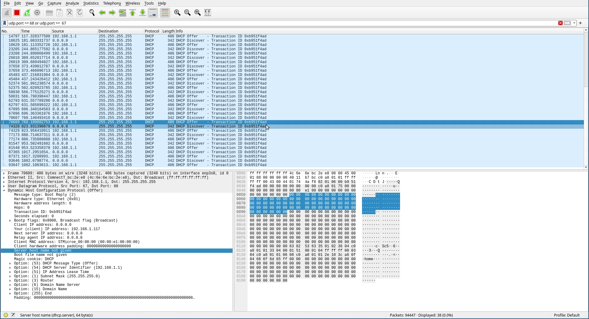

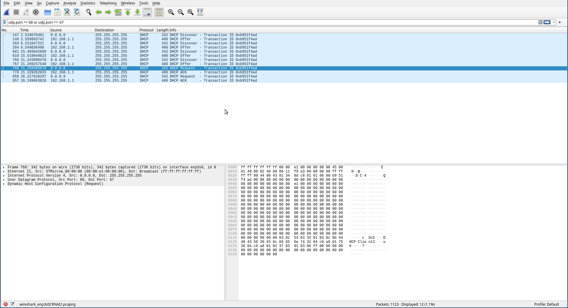

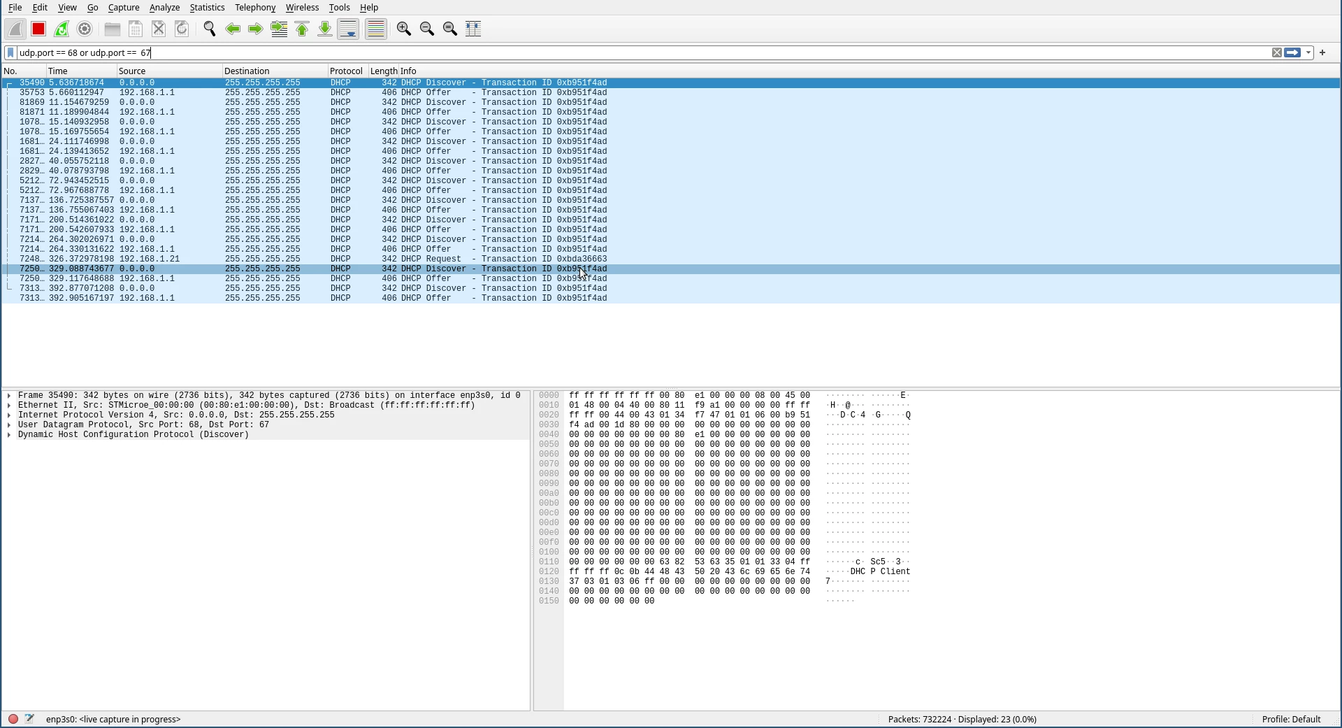

The system rarely completes all message transaction between the NUCLEO board and the DHCP server on my system. It usually stays alltime in a loop sending a DISCOVER and  ignoring the server's OFFER response.
From time to time, it succeds to perform the full message cycle DISCOVER-OFFER-REQUEST-ACK, but then remains in a loop continuously performing a REQUEST and ignoring the ACK.
I think I have a runtime or thread priority problem. I've tried everything and I can't get out of this dynamic.
The hardware works with other codes (not using DHCP).
I'm stalled here.

What is the network interface? ETH, wi-fi with some module, Bluetooth, slip? If ETH, note that getting it to work is not trivial. Before trying a higher protocol such as DHCP, test the MAC layer well: send and receive packets of various sizes & payloads, unicast and broadcast. Make sure packets are not lost or delayed for too long time, and data is not corrupted. If you are optimistic, maybe instead of the MAC test use iperf, with fixed IP addresses.

Is the LAN8742
Board NUCLEO-H563ZI

I debugged a few days ago the non working DHCP on my setup.
Proprietary board with STM32H743 and LAN interface dp8326e from TI.
To get the stackup working stable I had to fine tune the cache regions - disabling data cache for a test worked as well.
Otherwise it started working, e.g. with a FTP server, but stopped after a while.
Then I experienced a problem with DHCP server.
Linux Laptop got an offer with an IP from the defined range.
Linux Laptop requests that IP address and got a NAK.
Then some retries started and the process stops.
After debugging the DHCP process I found the reason in the nx configuration parameter: NX_DHCP_CLIENT_OPTIONS_MAX = 12 (nxd_dhcp_server.h)
Your DHCP packet shows a lot of options as well. Each listed option cost one or more entries.
The selected IP is requested in option 50. If this is late in the list and the option count of 12 is exhausted, the DHCP server to not see a request for a specific IP and send the NAK.
I set the value to 32 and voilá DHCP worked as expected.
