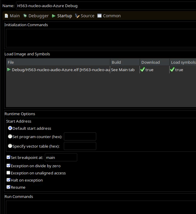

-> (..)/STM32Cube/Repository/STM32Cube_FW_H5_V1.1.1/Middlewares/ST/usbx/common/usbx_device_classes/
Look in debug setting: whats set for :: exception on unaligned...
stst9180
stst9180Author
Feb 20, 2024 9:03 AM UTC
This one is not set as on your picture.
I also checked up the corresponding core-register of the cpu, the irq on unalingend is also not set here.
Nevertheless it's firing such an IRQ.

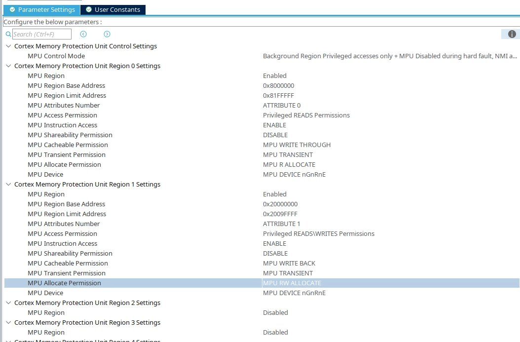

While generating the test-project i found out the following:
The issue is only appearing when the MPU is enabled in the CORTEX_M33 tab.
As this was not done by me manually, some initialization of our project seems to have done this.
The MPU settings are also attached and in the testproj.ioc
For now we may live with a completely disabled MPU.
If this is done the unaligned access does not lead to problems.
Regards
Pascal
