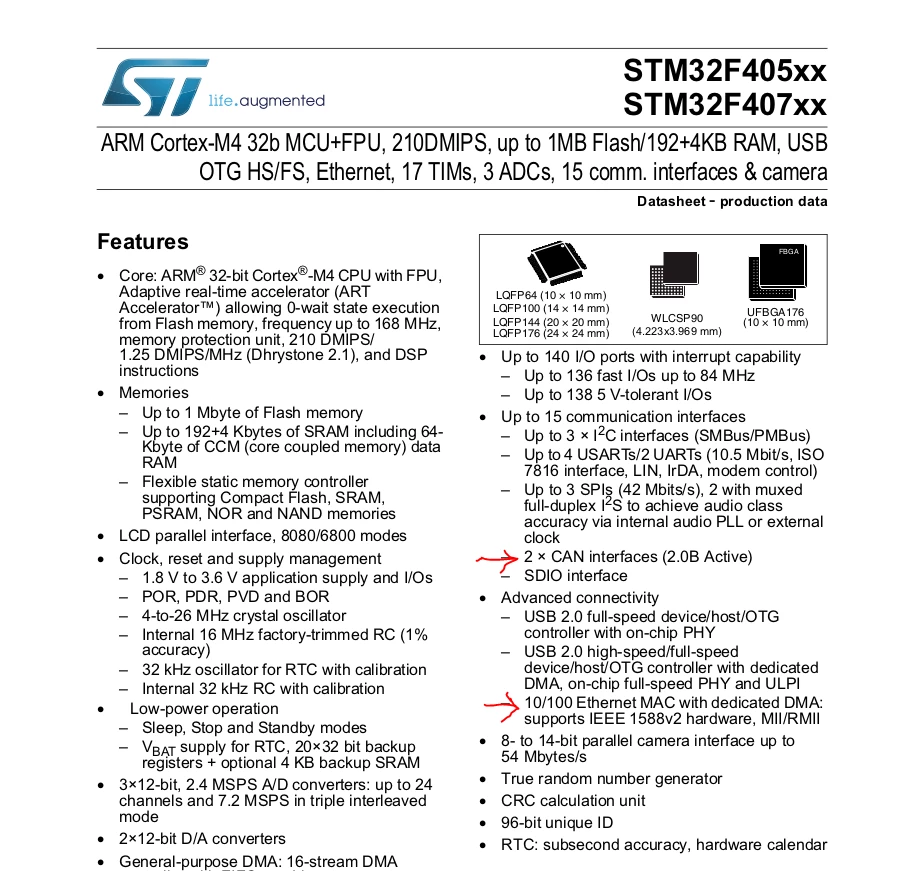

A F405/407 variant ?
> ... I tried to find more affordable option.
Affordability is usually a function of Flash size and pin count.
You could check what memory sizes and IO channels you need for your application, LQFP64 is the smallest casing variant.

TotoCobalt
Jun 30, 2025 5:45 AM UTC
Thank you for the reply.
1) STM32F407 will be a good option, but I thought that STM32H563 has lower price + better performance, that's why I wanted to know if I can add the FreeRTOS on it smoothly. I found that X-Cube-FREERTOS is available for STM32H563, but I also found some articles that people struggled to install it and some people believe that STM32H5 series can't be used with FreeRTOS.
If X-Cube-FREERTOS doesn't support full function as FreeRTOS, then I would consider STM32F407 instead.
2) I found the below article, that's why I believe that DFU via Ethernet is available for STM32F429.
STM32 Firmware Update With Embedded Web Server - Hackster.io
And, I use Zephyr OS for the other platform, and Zephyr OS supports DFU very smoothly with its MCUBoot. That's why I thought that Update capability (bootloader) and OS are related.
I did further research and I found that I need to create Bootloader project to do DFU with FreeRTOS. That's fine to have the separate Bootloader project, but I wonder if anyone already went through the path that I am exploring now.

> ...but I thought that STM32H563 has lower price + better performance, ...
I doubt that, at least for the plain MCU.
Although I'm sure there are H563 boards which are cheaper than certain F4xx boards, at least those with displays.
