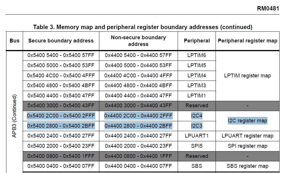

Hello @Changjiang,
The fix has been applied on SVD files for STM32H5.
Please find attached the new SVD files and the package will be published soon in ST web site.
9 replies
Dec 19, 2023 6:24 AM UTC
Hello @Changjiang and welcome to the Community :)
I will take the necessary action for fix.
An internal ticket number 169157 is submitted in order to update the STM32H56x.svd files.
(PS: Internal ticket number 169157, is an internal tracking number and is not accessible or usable by customers).
Thank you for your contribution.

Imen.DBest answer
Dec 25, 2023 1:12 PM UTC
Hello @Changjiang,
