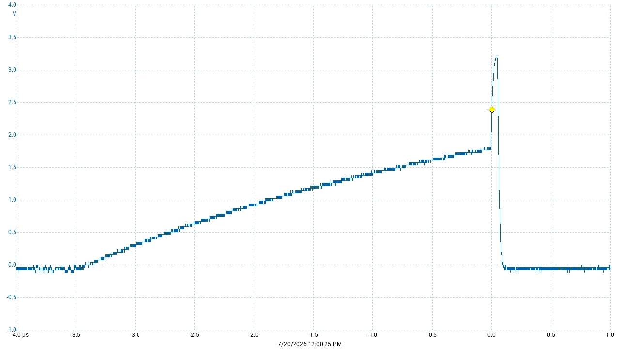

The first time, GetState reports READY, but the second time it does not, even though bytes_left is zero and TXC is 1, so an Abort is required before the next transmit. Unfortunately, this produces a nasty glitch on the MOSI line and, as the WS2812 protocol does not use the clock line, the glitch upsets the WS2812 LED strip.

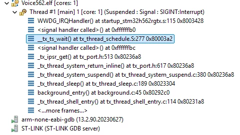

The system stops functioning during or soon after the first HAL_SPI_Transmit_DMA: if I pause it using the debugger, I get this stack trace:
Note that, in an answer to this this question, you suggested setting DMA priority to 2 and SPI priority to 1. I tried that as well, and the system still locks up.

TDKBest answer
Jul 20, 2026 16:58 UTC
The WWDG IRQ is often listed for the default handler which could mean the program is jumping to an IRQ that isn’t in the code. Look at VECTACTIVE bits in SCB to determine the IRQ it’s in and why it’s not implemented. Could be a typo in IRQ name, could be that it’s not generated at all.
In any case, stack trace points to other issues besides priority.
javalatteAuthor
Jul 21, 2026 07:40 UTC
You were right: there was no entry in stm32h5xx_it.c for SPI6. I added this, and now the transfer completes successfully. Thank you!
