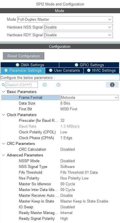

I simply configured the clock tree to use HSI (64MHz) → /2 → PLL1 (M=4, N=24, Q=4) = 48MHz.  I then use SPI2 prescaler to get 1.5Mbd out of PLL1Q (I tried lower data rate too).  The SPI module is configured in full duplex.

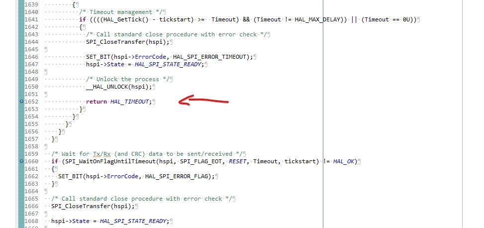

Using an oscilloscope, I can see the clock on PB13, the data being clocked out on PB15.  The transaction appers to work normally, but the code times out (HAL error code).  By setting a breakpoint in HAL code I can see that it fails because the code expects RXP to be set at some point, but it is never set.

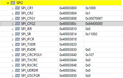

  • I checked that the SPI module configuration looks sound.  Sorry for the compact form.  The settings match my config above and I’m really configured as Full duplex master (COMM=00’b), so the data should be clocked in at some point.
  • No matter the length of the transaction, the module clocks out whatever it has to clock out, but it won’t raise RXP flag even once.
  • There are no error flags at all that are set, so it appears the transaction works just fine and TSIZE it accounted for as expected.

Side note: when debugging I didn’t step the code as reading the rx data register through the SFR window would clear RXP, so I just put a breakpoint at the line where it would return the TIMEOUT error code in the HAL code and I pressed run to reach directly that place.  There is a variable that should be decrementing whenever RXP is set, but that variable still holds the initial amount of bytes to read, confirming that RXP never gets set.

I linked a zip file of the code.  The code always times out at location indicated with read arrow.  It never reaches the bottom breakpoint.
