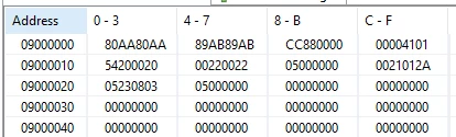

By running:
uint16_t example_data = 0;
example_data = *(uint16_t*)(0x09000000U) ; //ECCCORR reg getting filled and the variable is 0xaa80
example_data = *(uint16_t*)(0x09000002U) ; //No change
example_data = *(uint16_t*)(0x09000004U) ; //After execution NMI Handler is called, ECCDETR reg getting filled
The memory content is:
And correction registers content:
FLASH->ECCCORR = 0100 0000 0010 0000 0011 0000 0000 0000
FLASH->ECCDETR =  1000 0000 0010 0000 0011 0000 0000 0001

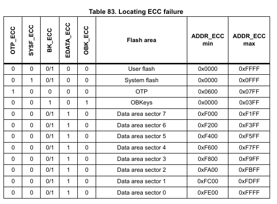

Both registers points EDATA_ECC bit, what is:
EDATA_ECC: ECC fail for corrected ECC error in flash high-cycle data area
It indicates if flash high-cycle data area is concerned by ECC error.
What corresponds to the device behaviour. I have doubts about ECC error address:
Register description: The address in ADDR_ECC is relative to the flash memory area where the error occurred (user flash memory, system flash memory, data area, read-only/OTP area).
The address pointer is 0x3000 and 0x3001 what correspond to user flash (7.9.10)

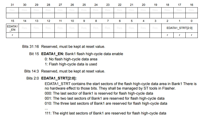

Hello @Mks1
The errors you are experiencing may be due to accessing the high-cycle data area of flash memory (0x0900_0000 - 0x0901_7FFF) before it has been properly enabled and configured. Please ensure that the EDATA enable and start configuration bits are correctly set prior to accessing this region, as per the reference manual.
In order to give better visibility on the answered topics, please click on 'Best answer' on the reply which solved your issue or answered your question. Saket_Om
Mks1Author

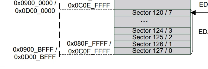

Aug 6, 2025 10:39 PM UTC
FLASH_EDATA1R_CUR just before and after is 1000 0000 0000 0111, what means that flash high-cycle data is enabled and the last eight sectors of Bank 1 are reserved for eeprom emulation:
In that case I ought to be able to read any data between 0x0900 0000 and 0x0900 BFFF. Correct me if I am wrong.
Reading from regular Flash memory (for instance 0x0800 0000) does not cause any trouble.
EDATA2 is zeroed.
Any ideas how to proceed with debugging?
