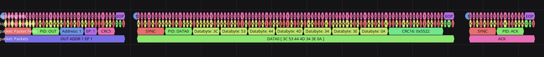

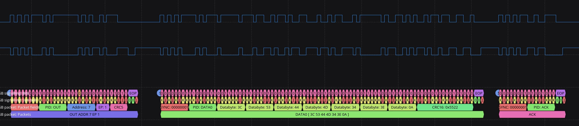

We used an logic analyzer to see if there was any difference in the messages that were being send, but we don't see any difference, except for the address. In the images below, you can see the images. image(3) is the image from Laptop to the sensor. image(4) is the image from PCB to the sensor.

Hi @Sara02
Would you attach detailed breakdown of the USB traffic. Could you confirm the sensor is enumerated as intended. If possible to visualize enumeration in IO Terminal or via HyperTerminal.

The enumeration looks like it goes right as far as I can see. When I check the settings they seem similar to what I see when I check it with the sensor connected to my laptop.

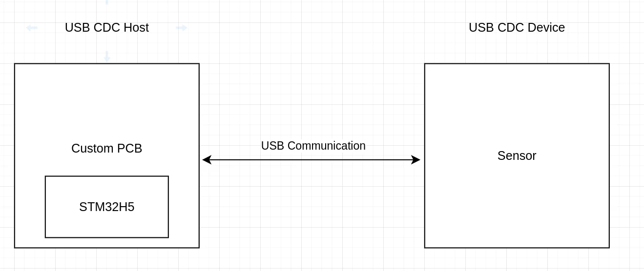

Dec 12, 2024 2:53 PM UTC
Why should I use these commands on my laptop when I am trying to get the communication from my custom PCB with embedded STM32H5 chip to a USB sensor working?
Maybe this picture makes it more clear what I mean and how it should work.
If I connect the same sensor to my laptop it works. In that case the USB Host would be my laptop.
If I would add the captured data, you would see a working connection between my laptop and the sensor, of which we already know that it works. Or is there something else your looking for in the captured data?
