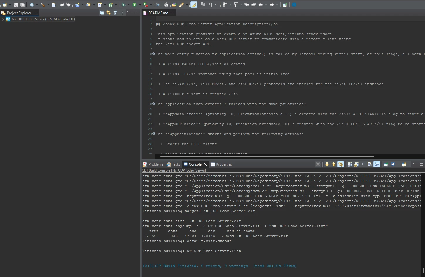

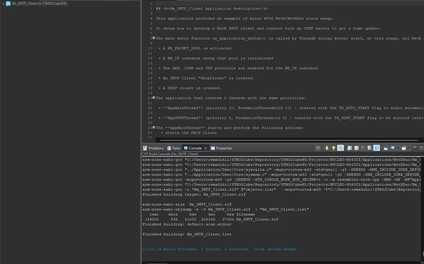

Hello @SiSte ,
can you try to open the project from C:\Users\your_name\STM32Cube\Repository\STM32CubeH5\Projects\NUCLEO-H563ZI\Applications\NetXDuo\Nx_SNTP_Client\
and compile it as i Don't seem ti get the same issue as you are describing even with version v1.3 of CubeFW
Try to not import it from project selector in MX and tell me if you are able to compile.

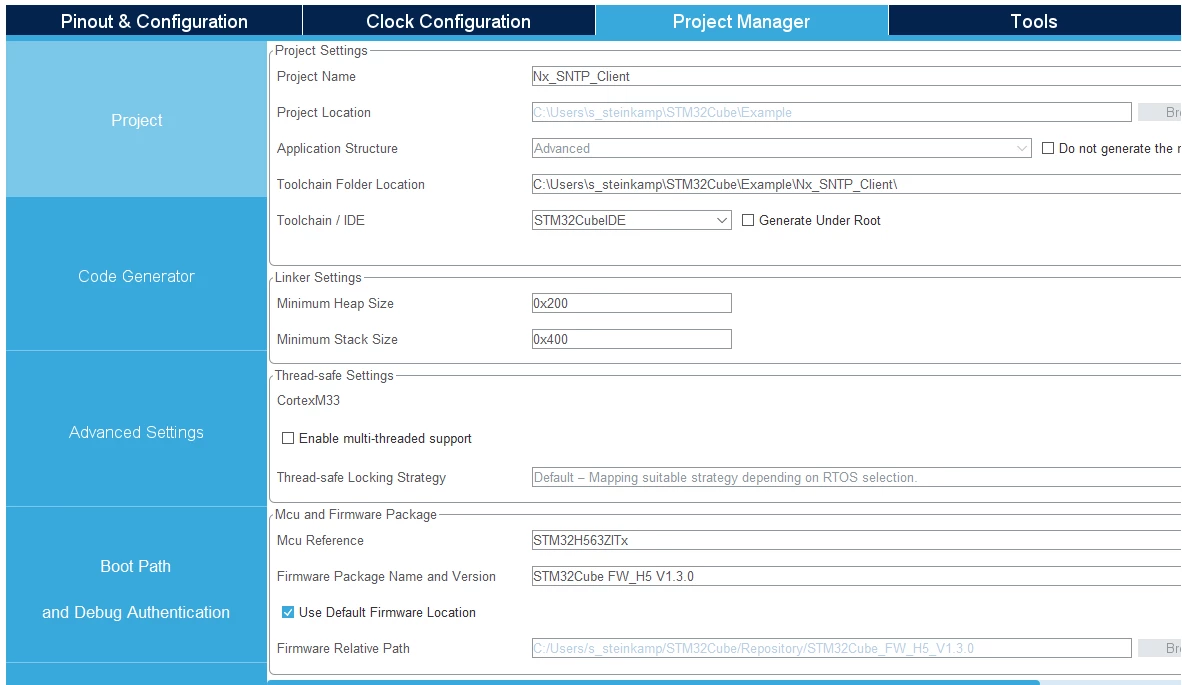

SiSteAuthor
Sep 2, 2024 9:56 AM UTC
Hi and thanks for your reply,
I also run the IDE v1.16. I assume, that my FW Version is v1.3.0, as this is shown in the Cube Project Manager tab:
I did not clone the example code on my own, as far as I recall, CubeMX downloaded it.
