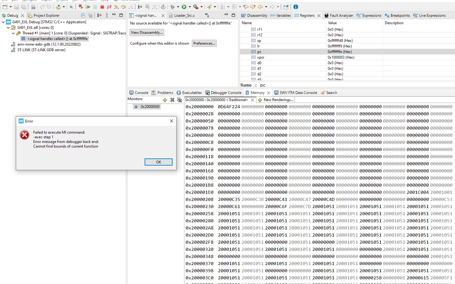

I am working on an external loader for STM32G491.
For STM32F4 series microcontroller, everything works fine, but STM32G491 does not work.
I observed that the external loader program is loaded into RAM, but does not execute.
I did some tests with running the program from RAM in debug mode.
I observed that if the FLASH memory is erased then the program loaded into RAM does not want to start (see image below).
If there is any previous running program in FLASH memory, then loading the test program into RAM and running it with the debugger works fine.
For STM32F4 series microcontroller, I can always run the program from RAM ( also for deleted FLASH memory - which seems to be normal).
The problem with the external loader is that the debugger initially deletes the processor's FLASH memory, then using the external loader to erase the external memory, but the external loader no longer works, because the FLASH memory is deleted.
I use CubeIDE Version: 1.14.0  &  HAL library

I did some additional tests.
I think the main problem is on the side of the ST-LINK programmer.
I have a log of the programming process.
At the beginning the FLASH memory of the processor is erased - address 0x8000000.
From address 0x20000004 the debugger loads 0x000007A0 bytes of the loader with which it will erase the internal FLASH memory.
Next sets PC 0x20000005 and starts the erase procedure.
Next proceeds to erase the external flash memory.
Next loader starts to erase external mamory.  (Erasing Segment <1> Address <0x90000000> Size <37>Bytes)
Sets PC 0x200006C1 and starts erasing.
But what is at address 0x200006C1 ?
The external loader has not been loaded.
From .map file we know that the Init() function of the external loader is at address 0x200006C1 (.text.Init 0x00000000200006c0 0x88 ./Core/Src/Loader_Src.o), but it has not been loaded.

How can I fix this?
Tesla DeLorean
Guru
Dec 23, 2024 8:44 PM UTC
>>How can I fix this?
Remove the Internal Flash content from your External Application?
The linker script for that is evidently describing FLASH content at 0x08000000
