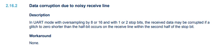

Hello @RHert.1,
The first behavior may be due to the device limitation described in the STM32G4xx Errata sheet:
For the second issue related to bootloader: which bootloader version are you using?
