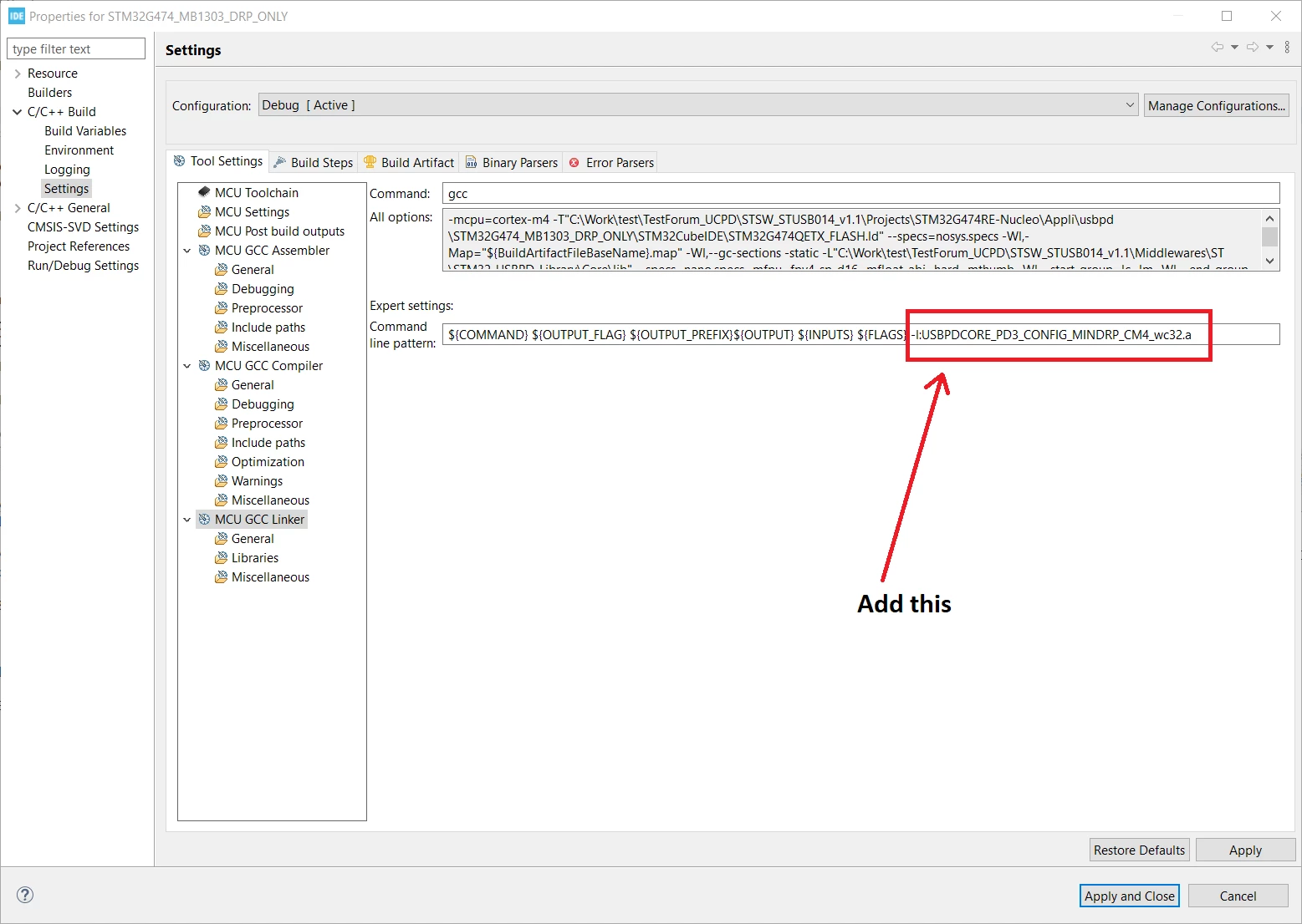

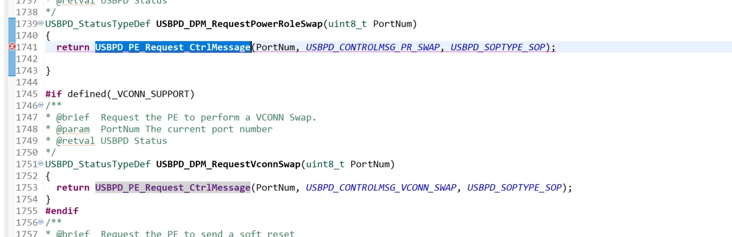

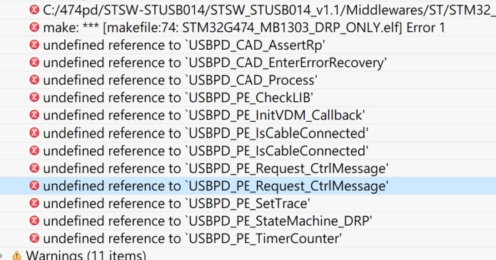

I have tried the application "STM32G474_MB1303_DRP_ONLY" from STUSB014-v1.1.1 to start my development. but there is a build break by some function in usbpd_core.h.
But the related files and libraries are included in my project and listed in the project explorer.
is there any step need to check??
using CubeIDE 1.9
Thanks a lot

Same here...
For some reason the library USBPDCORE_PD3_CONFIG_MINDRP_CM4_wc32 is not linked, as specified in the project settings.
As a temporary fix, please check my attached picture

Hi Mike_ST
Thanks for your answer
it works!!​
