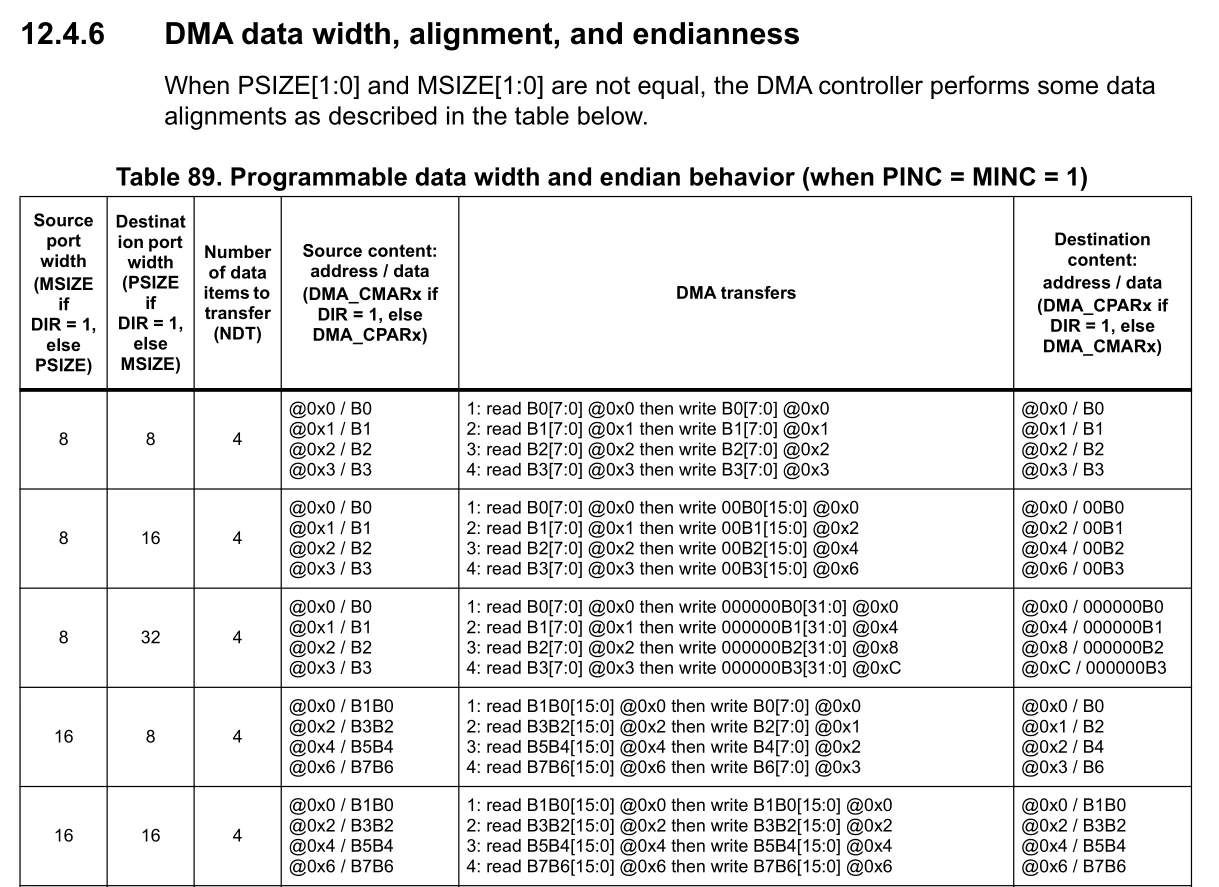

August 31, 2026
IMHO, a lot of confusion comes from DS table 89, which gives a false illusion about DMA transforming magic capability from any source size to any destination size. (And dropdown boxes in the STMCubes do the same things). Nothing of the kind. It should be stated that DMA is always a 32-to-32 device.
When an 8/16-bit limited peripheral needs to talk with 32-bit forever DMA, it must have some hardware logic to do packing/unpacking. These hardware logic elements may be integrated into FIFO or may not.
So, if we see that the ADC is capable of "squeezing" two data (<=16 bits) samples into one 32-bit DMA word, it means packing logic was built into the ADC. And if DAC is not managing splitting service 32 down to two 16-bit, it simply means there is no hardware unpacking logic designed to do so.
It has nothing to do with DMA. Just exceptionally interfacing bolted-up peripherals' features.
And if some timers repeat a byte 4 times all over a 32-bit word, it's simply a timer's problem. Errata. DMA/Bridges/AHB/APB should not ever care about misunderstandings from the receiver side.
