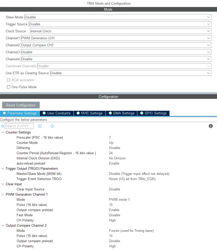

Hello everybody,
I bought a STM32G431RB Nucleo. I created code for it with the STM32 CubeMX and modiefied the code in the STM32 CubeIDE. I want to access "HAL_TIM_PeriodElapsedCallback" and "HAL_TIM_PWM_PulseFinishedCallback", I read that this is possible by calling "HAL_TIM_Base_Start_IT" for "HAL_TIM_PeriodElapsedCallback" and "HAL_TIM_PWM_Start_IT" for "HAL_TIM_PWM_PulseFinishedCallback". But when I do that, the STM32 seems to crash.
Am I doing something wrong, or is this simply not possible?
Thank you in advance!

TDKBest answer
Aug 31, 2021 6:57 PM UTC
More than likely the interrupts are being called so frequently that your main loop cannot progress. You're calling multiple interrupts every 200 timer ticks. That's not a lot of time.
Slow the timer down by a couple of orders of magnitude and try again.

FBurk.1
FBurk.1Author
Aug 31, 2021 7:08 PM UTC
Hello TDK,
thanks a lot for your reply, it was correct!
