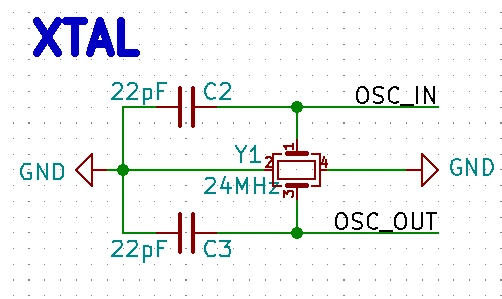

SKang.2
SKang.2Author
Feb 19, 2020 4:34 PM UTC
Sorry for giving vague description for my situation ...
Can you check whether my external crystal circuits correctly composited?
The error was resolved when I switched clock source to HSI ...
Should I reduce C2 and C3 on here?
In this case, Pin 2 and 4 of crystal is just shield pin ... don't care it.
waclawek.jan
waclawek.janBest answer
Feb 19, 2020 4:50 PM UTC
So it was missing clock to USB?
But, you've said above,
> It is set to use HSI48,.
So how is it?
For crystal capacitors see AN2867, but generally 22pF for 24MHz should be in most of the cases OK and the oscillator should work, even if not optimally. Check HSE oscillations by outputting it to MCO and measuring there.
SKang.2
SKang.2Author
Feb 19, 2020 5:39 PM UTC
For your question; I'm not sure what the exact cause was. When I changed the clock source for the entire system to HSI from the HSE clock, the program run without any error.
At least, it wasn't because of the missing clock to USB. The clock source for the USB peripheral has always been HSI48 without change ...
At this point, guessing that the crystal circuit has some trouble seems reasonable.
To ensure this, I should measure the exact clock speed of HSE... as you mentioned.
I'll check it, thanks.

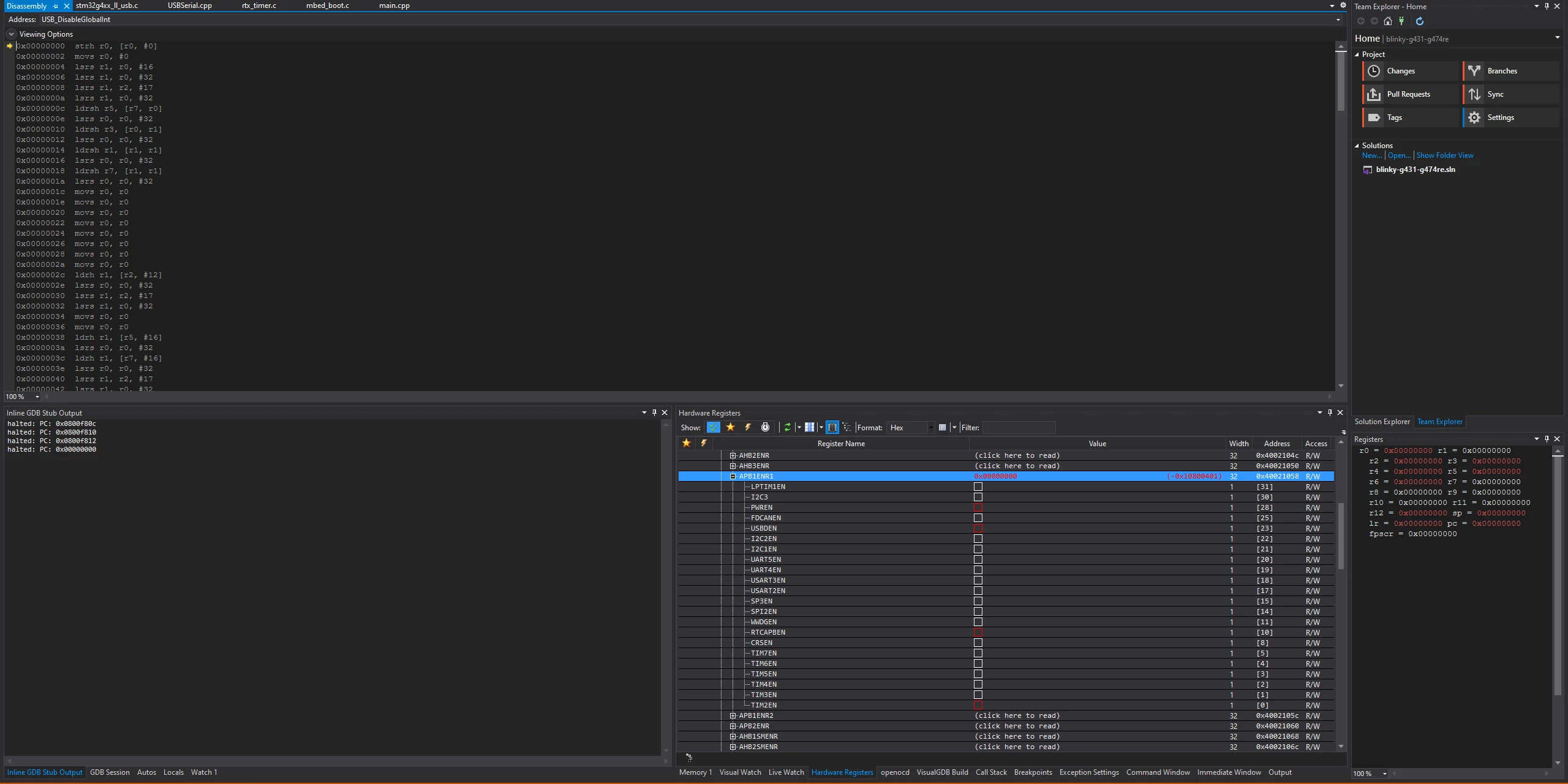

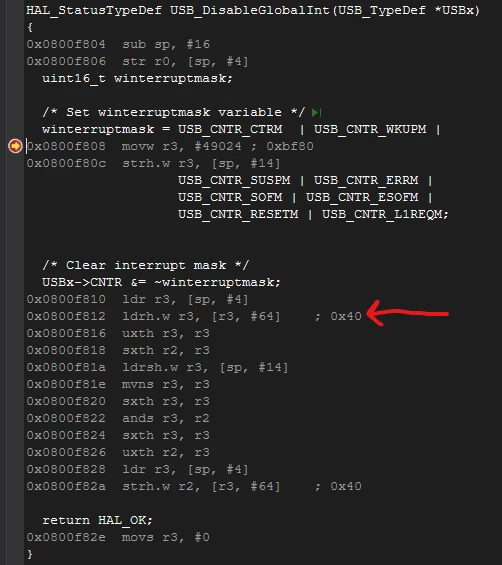

WPete.2
Visitor II
Aug 13, 2020 2:49 PM UTC
Hi!

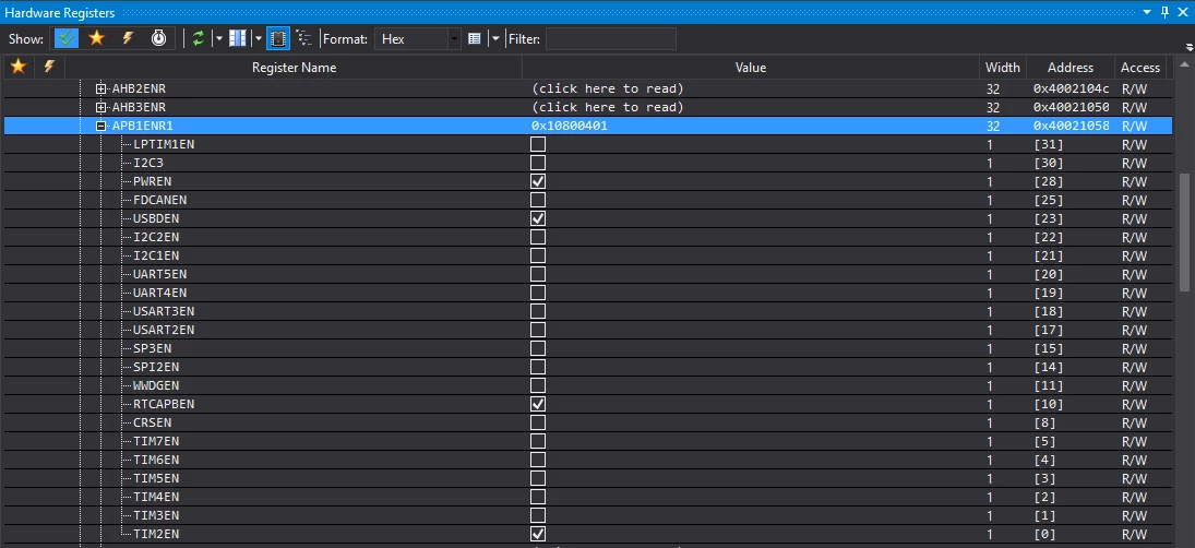

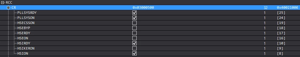

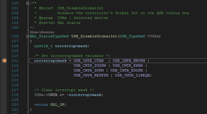

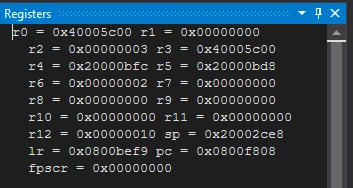

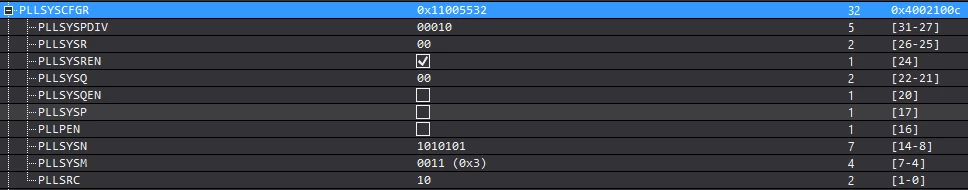

I'm actually facing a similar issue, also in USB_DisableGlobalInt and with G431KB.
The MCU is operating as normal for other peripherals, e.g. I can run a simple blinky program and it works fine.
But when i enable the USB functionality, the MCU ends up with a fatal crash in USB_DisableGlobalInt.
I've traced this down to accessing the USB_FS_DEVICE registers, for example CNTR. Reading this register causes a fatal crash. (screenshot)
I've verified that RCC->APB1ENR1->USBDEN is set. (screenshot).
I'm using HSI (screenshot of RCC->CR). (screenshot)
Note: The regnames don't exactly match the STM RM0440 PDF manual, but the bit numbers is listed on the right for refence.
I've tried a number of options, and really am quite stuck now :(
Hoping someone here might have the same issue or some hint on how to resolve it.
@SKang.2​ : Did you ever figure out the true cause of your issue?
@WPete.2​ : You had some good comments on SKang's issue - any insights as to what I might be facing?
Detailed screenshots below...
Crashing Source Code Segment:
Disassembly
Fatal Crash (after executing ldhr.w instruction (i.e. reading USB_CNTR@0x40005c40)
I also get a crash if I use the debugger to read that memory space.
waclawek.jan
Aug 13, 2020 6:50 PM UTC
Next time, please start your own thread, with links to relevant threads.
How is the 48MHz clock (USB, RNG) selected? See RCC_CCIPR.CLK48SEL. If you did not touch it, it's set to HSI48.
HSI48 is enabled? See RCC_CRRCR.
WPete.2
Visitor II
Aug 13, 2020 7:55 PM UTC
Hi!
Ah, hah! Yeah, that was it. RCC_CRRCR.HSI48 was not enabled, so the USB was not getting a proper clock. Flipped the bit and then it went just fine!
Thanks!!
