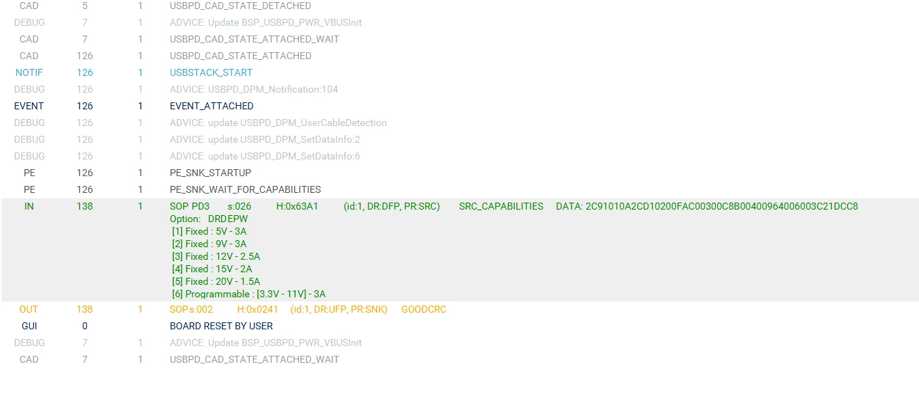

I am having big troubles getting USB-PD sink on the STM32G431KBT to work. I am using CubeMX and following the AN5418 Complete USB-PD application example and using FREERTOS 10.3.1 and USBPD 3.3.0.
Connected to my wall adapter the debug traces looks as follow:
The source always resetting its power after the source capabilities are recieved. And the board restarts.
Any ideas how to fix this?

Hi @BoSt
I assume the sink cannot evaluate the received source capabilities to determine the best power profile to request.
Did you check user code section dedicated for evaluating capabilities

Thanks, for reply!
I have tried both the:
void USBPD_DPM_SNK_EvaluateCapabilities(uint8_t PortNum, uint32_t *PtrRequestData, USBPD_CORE_PDO_Type_TypeDef *PtrPowerObjectType)
/* USER CODE BEGIN USBPD_DPM_SNK_EvaluateCapabilities */
USBPD_USER_SERV_EvaluateCapa(PortNum, PtrRequestData, PtrPowerObjectType);
and the code from the example:
uint32_t *srcPDOs;
uint32_t srcPDOCount;
// Retrieve Source PDOs for evaluation
USBPD_PWR_IF_GetPortPDOs(PortNum, USBPD_CORE_DATATYPE_SRC_PDO, (uint8_t*)&srcPDOs, &srcPDOCount);
USBPD_SNKRDO_TypeDef rdo;
/* Initialize RDO */
rdo.d32 = 0;
/* Prepare the requested pdo */
rdo.FixedVariableRDO.ObjectPosition = 0;
rdo.FixedVariableRDO.OperatingCurrentIn10mAunits = 50;
rdo.FixedVariableRDO.MaxOperatingCurrent10mAunits = 50;
rdo.FixedVariableRDO.CapabilityMismatch = 0;
*PtrPowerObjectType = USBPD_CORE_PDO_TYPE_FIXED;
*PtrRequestData = rdo.d32;
/* USER CODE END USBPD_DPM_SNK_EvaluateCapabilities */
with the same results. The board are still resetting!

Hi @BoSt
Is PPS Programmable power supply activated? Could it be disabled for test? Would you share minimal project to reproduce?
