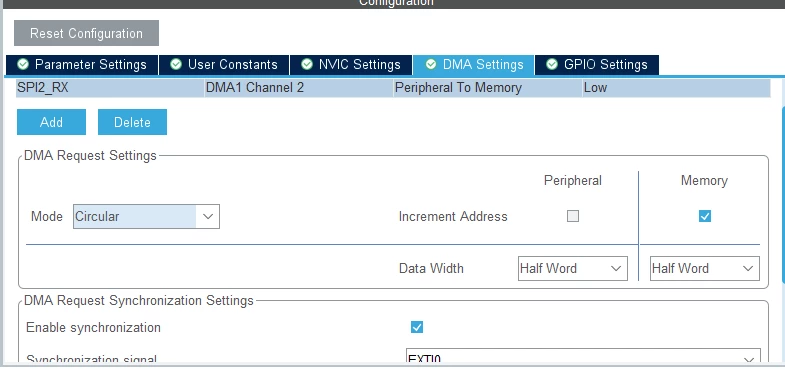

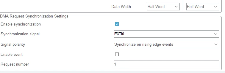

I tried it also to start the SPI DMA read with the cubeMX:
The trigger was here Interrupt from the Input EXTI0, even here it does not worked.
I init it in the main-function with:
#define SIZE_SPI_ADS8509 1036
uint16_t aRxBuffer_SPI_ADS8509[SIZE_SPI_ADS8509];
ret = HAL_SPI_Receive_DMA(&hspi2, (uint8_t *)aRxBuffer_SPI_ADS8509, SIZE_SPI_ADS8509);
Dec 20, 2024 2:30 AM UTC
Ahh, it's a slave. I missed that. If you're just receiving, then you don't need to worry about TX at all.
In that case, I don't understand what TIM1 is doing here. If you want to receive SPI data into a circular buffer, that can be done without a timer.
If your register level code isn't working, I would suggest coding it up using CubeMX and HAL and HAL_SPI_TransmitReceive_DMA(...), and then copying those register settings. It should be straightforward
