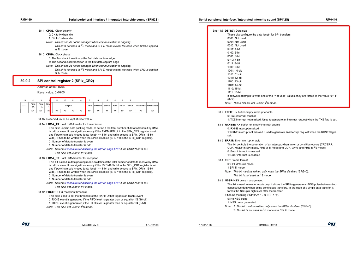

Thank you very much, that already got me in the right direction. Now, there only remains one issue, it won't work when I set the SPI CR1 data size bits. No matter if I use SPI_DATASIZE_8BIT or SPI_DATASIZE_16BIT, nothing happens at the SPI. When I just don't set them, it looks like it transfers 2x8 bits (haven't validated that, just looking at the clk) with an about one cycle pause in-between. That seems to result from the data packing. Is there some other configuration issue that could cause that? 16 bit mode works just fine otherwise when configured using the HAL, which I want to avoid having in the final code.
As a side node, opposed to what I've read in some other threads on this forum, it seems like the CS signal generated by an STM32G4 series SPI peripheral can be configured to be just as one would expect, suitable to control an SPI ADC.

waclawek.jan
Oct 1, 2024 8:21 AM UTC
If something does not work as expected, always start with reading out and checking content of registers (with having in mind that debugging is intrusive).
Data size is in CR2, not in CR1.
Generally, never use Cube-defined symbols (constants) as they may be different than what you think; use exclusively those defined in the CMSIS-mandated device header. This has the added benefit that they contain the register name, so it's less likely you apply them to inappropriate register. E.g. here:
SPI1->CR |= (0b0111 << SPI_CR2_DS_Pos)  // 8-bit
