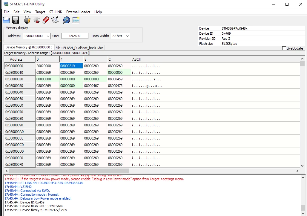

So here are my steps:
  1. Compile example program with "FLASH_BANK2" define active

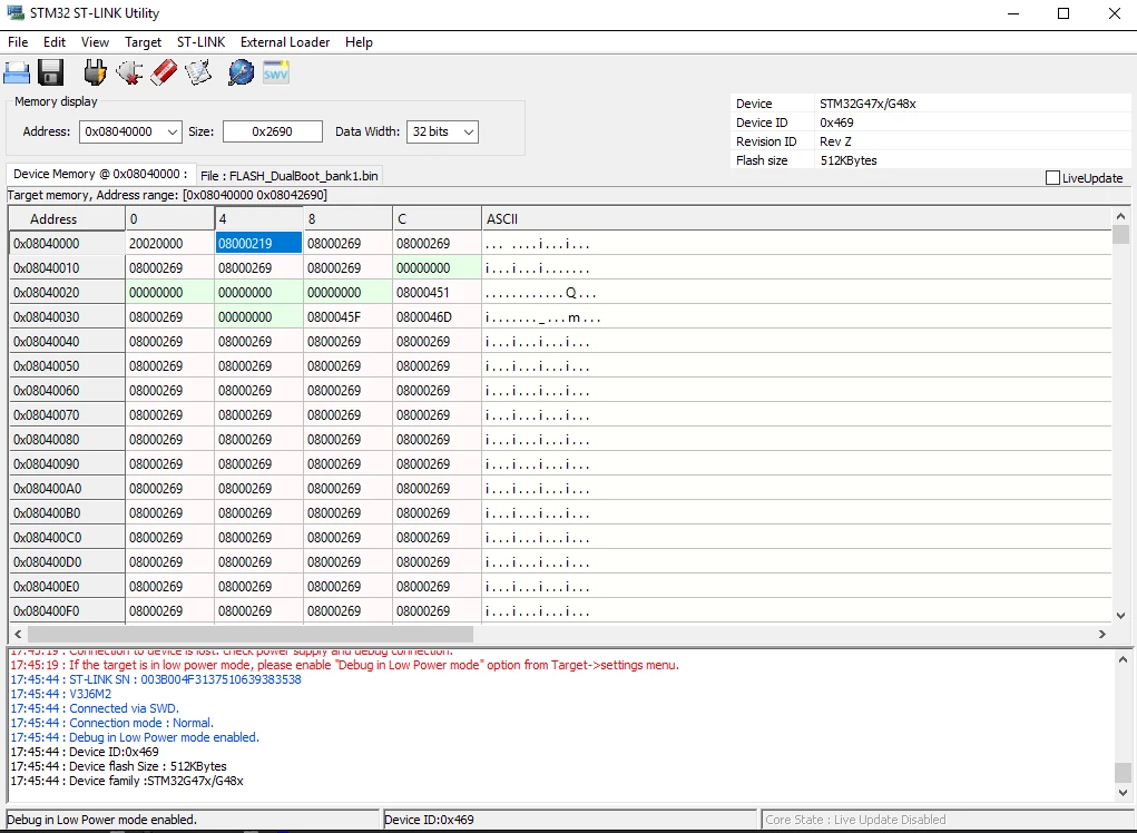

  2. Flash binary to address offset 0x08040000 using ST-LINK
  3. Compile example program with "FLASH_BANK1" define active
  4. Flash binary to address offset 0x08000000 using ST-LINK (no erase)
  5. Verify that the flash content actually contains the two programs at the desired address offsets

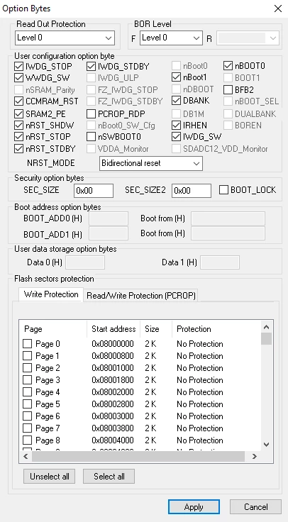

  6. Make sure the BFB2 bit in the option bytes is cleared
  7. Re-power the eval-board
  8. I see the LED2 blinking --> correct
  9. Push the "user button" B1
  10. See no LED blinking anymore --> wrong (I should see LED2 being on)
Could someone verify this behavior?
Attached you can find screenshots of the flash content and option bytes set.

Hello @MScho.1​ ,
After analysis, this issue is due to bootloader and it has been fixed with bootloader version 13.4.
So, can you please confirm that you are using a board with bootloader v13.4? or share the binary of the applications that you load in Bank1 and Bank2 ?
In fact, the example is not working as you reported when using bootloader v13.3 and older.
To be ensure that the bootloader version used is v13.4, please folow these steps:
- connect the board to STM32Cubeprogrammer
- read the address 0x1FFF6FFE
- the first bytes must have value 0xD4:
D ==> 13
4 ==> .4
Otherwise, the FLASH Dual Boot example will not be working with older releases.
Note that the example is working using IAR toolchain and BL 13.4, but we have the same issue as you reported when using Bootloader v13.3 and 13.2 .
