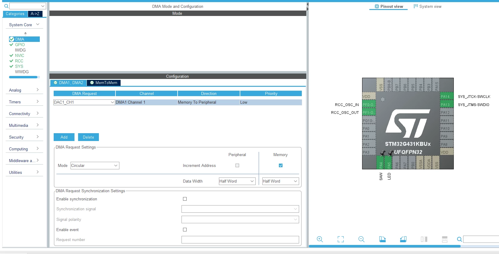

I'm working with an STM32G431KBUx and trying to output a waveform via DAC1 using DMA and TIM6 as trigger (TRGO). I’ve successfully configured the DAC and DMA using STM32CubeMX.
However, the DMA callbacks HAL_DAC_ConvCpltCallbackCh1 and HAL_DAC_ConvHalfCpltCallbackCh1 never get called.
Here’s what I’ve checked so far:
  • DMA handle is linked manually:
    hdac1.DMA_Handle1 = &hdma_dac1_ch1;
  • Trigger is set to Timer 6 Trigger Out event.
  • DMA is configured in Circular Mode.
  • I'm calling HAL_DAC_Start_DMA(...) with a buffer of 2 * 64 samples (12-bit aligned).

Best answer by KnarfB
After reading STM32G431KB DAC DMA not working - Page 3 - STMicroelectronics Community
in the DMA setup, change Data With for the Peripheral to Word.
hth
KnarfB

You may find the raw interrupt handler in the *_it.c file which dispatches the irq to HAL. Set a breakpoint there and, if it is hit, follow the path through HAL.
hdac1.DMA_Handle1 = &hdma_dac1_ch1; is should not be needed. See __HAL_LINKDMA in HAL_DAC_MspInit.
How are the DMA settings? Maybe you add the .ioc.
hth
KnarfB
VadIzmalAuthor
July 31, 2025
.ioc file is attached
KnarfB
KnarfBBest answer
July 31, 2025
hth
KnarfB
July 31, 2025
Is the DAC working as expected? Is the NDTR register changing? Is the Timer CNT register changing? The rate of samples is pretty low. It'll take a few seconds for a half-buffer to be pushed out.
