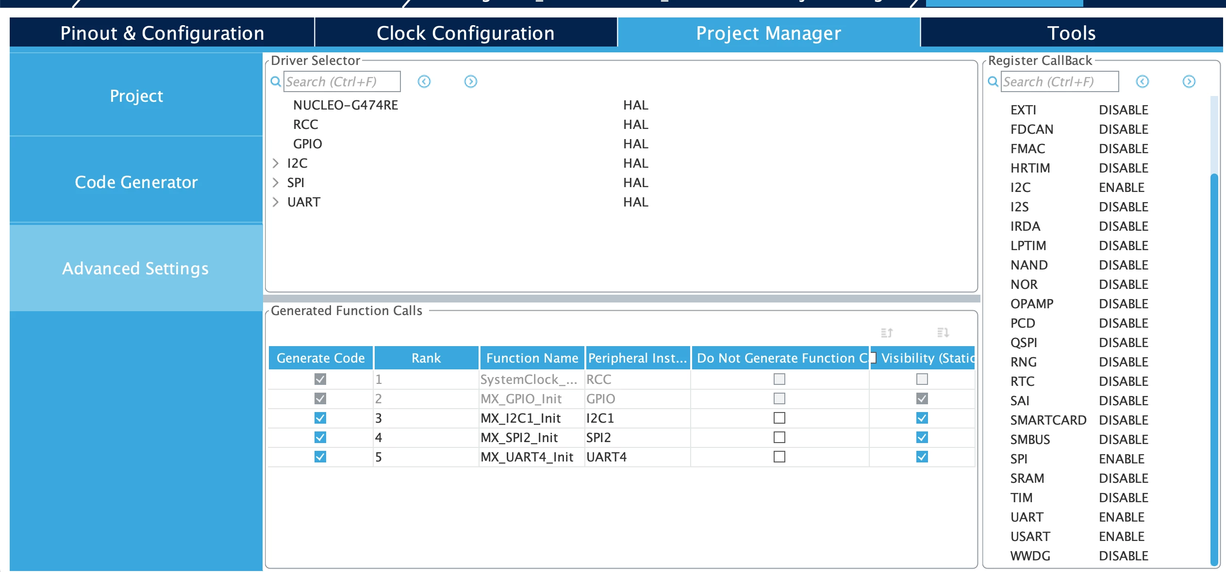

In a nutshell, as you turned on the UART register callback option as shown in the figure below, the virtual com port fails to print any items.
After further inspection, I believe it is a bug in `stm32g4xx_nucleo.c`, under function `BSP_COM_Init`. It seems like someone forget to index the `IsComMspCbValid` to find the validity of the given `COM`, as shown in code below.

 This causes, `BSP_COM_RegisterDefaultMspCallbacks(COM)` never get called and the `COM` is never initialised. Thus the lack of response when using the `printf` function.
After adding indexing as shown in code below, the `printf` successfully work as intended.
 if (IsComMspCbValid[COM] == 0U)
 if (BSP_COM_RegisterDefaultMspCallbacks(COM) != BSP_ERROR_NONE)
 return BSP_ERROR_MSP_FAILURE;
Hopefully, the team could fix this small issue.
