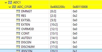

I am trying to perform injected conversion of two channels in ADC1 (STM32G431x), and I wish to trigger them in discontinuous mode. The ScanConvMode is enabled and the discontinuous mode for injected measurement is also set (injectedDiscontinuousConvMode = ENABLE). However, the conversion still happens continuously.
I had to hard set the bit (SET_BIT(ADC1->CFGR, ADC_CFGR_JDISCEN)) to make it work in discontinuous mode.Any help here will be appreciated! Thanks.

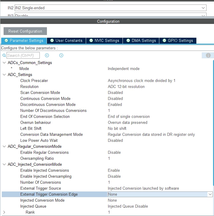

Here is  the ADC .IOC file config, does it comply with your needs?
However i will admit that i found a weird behavior with
  sConfigInjected.InjectedDiscontinuousConvMode = DISABLE;
always generated as disabled no matter how it was configured in STM32CubeMX, I will check it
I hope this will help you troubleshoot your issue root cause for now

Thank you for the response. For the discontinuous mode to work, the ScanConvMode must be enabled, right? From your code segment, it does not seem like it. I will try to see if the JDISCEN bit is getting set normally, but I guess not.
